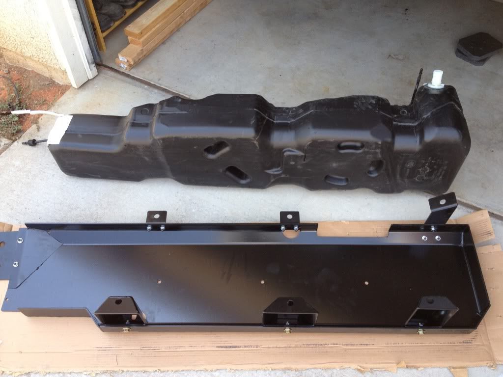

Synergy Gas Tank Skid

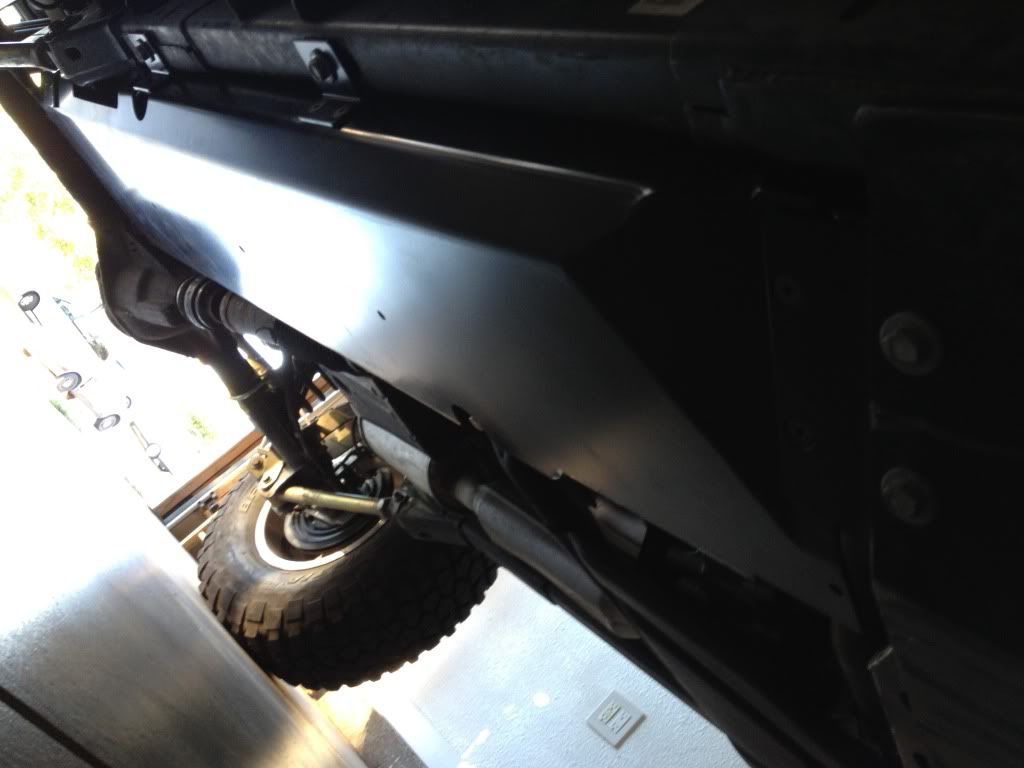

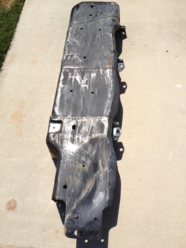

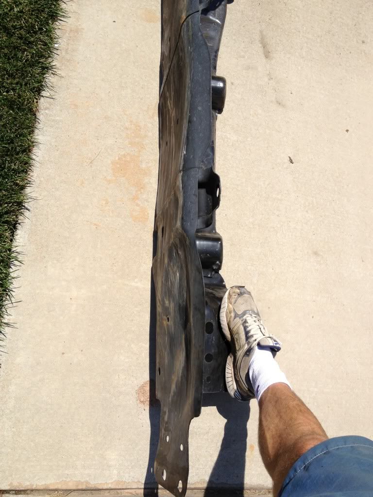

Stock skid - Not stout at all, but served it's purpose...

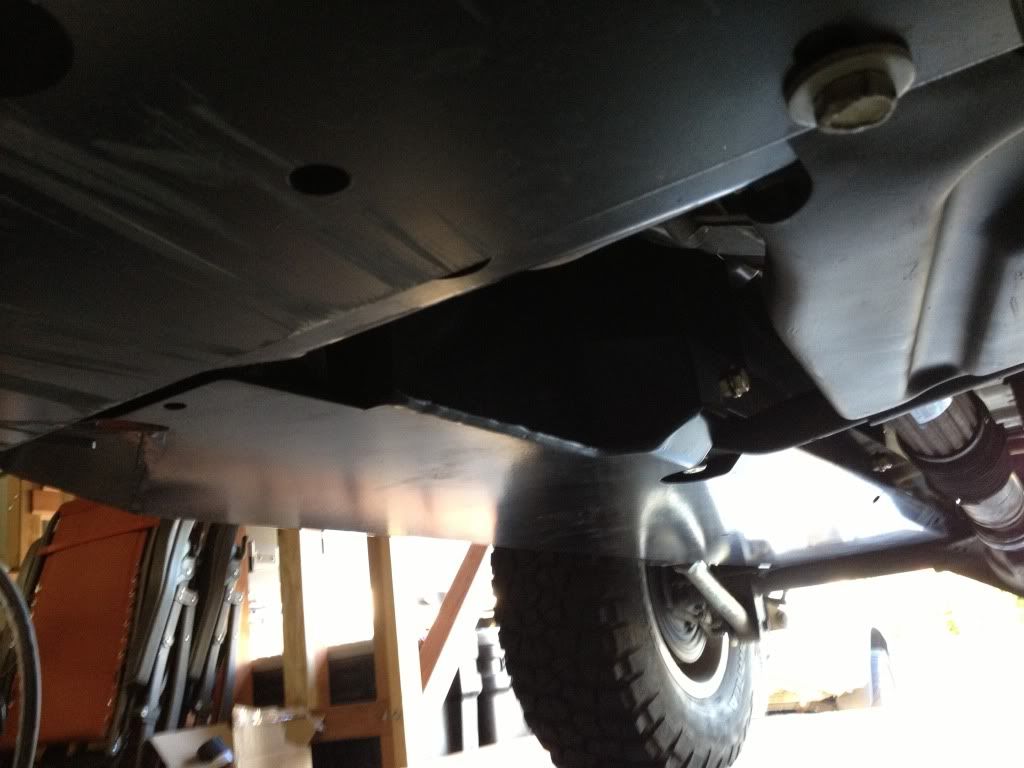

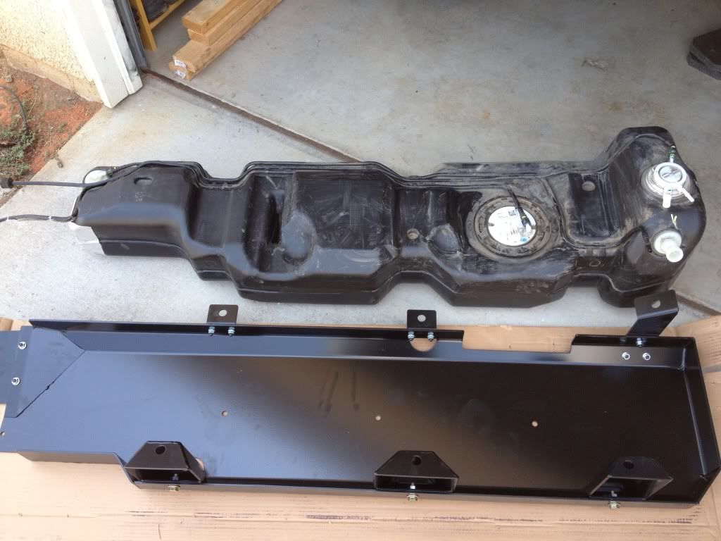

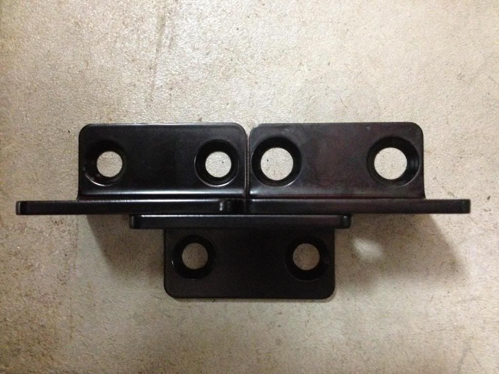

Synergy Skid - Definitely stout, but I ran into some issues with the brackets and countersunk holes. Three of the brackets were countersunk way too far...the flat head allens would bottom out on the skid before drawing the bracket up tight to the skid. Called up Synergy, and they replaced them for me, but the end result was the same, just not as big of holes. In the picture below, the bracket on the right came with the skid (huge holes), and the other two are the replacements (not as big, but still too big).
All in all not a big deal, but a little frustrating. In the end I just drilled out the holes on the skid, and had to touch them up with some paint.

Marco, Poly skid looks nice! Did you happen to take any before/after measurements or can just eyeball the sizing of the new skid with respect to how close it comes to the rear driveshaft flange? With the stock skid, I had to pound in the stock skid's area to make room for the flange (Woods shaft) as it made contact and grinded into the skid at extreme flex.
The Poly/Synergy skid is pretty form fitted to the tank, but I can take some measurements at rest if that helps? If not, maybe I can swing by MC and flex it out and see if it hits/measure it.
