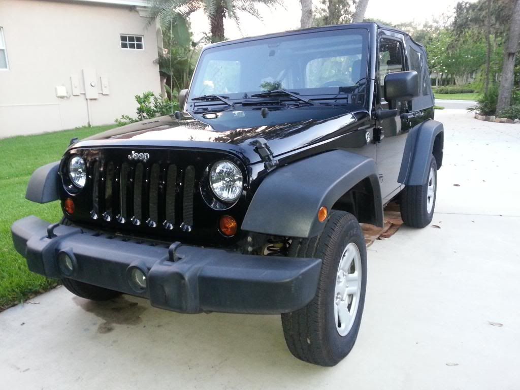

So I figured I start up my build thread. Many of you have been great so far in helping me move along with ideas on how to end up with my jeep just how I want it. I'm starting with a 2 door sport and I'm working to develop a LCOG beach cruiser. I'm in Tampa and not too close to any major rock crawling so I won't be doing much of that. I'm working on getting a look somewhat similar to the River Raider Dune Raider. We'll see how it turns out. Anyway here is a picture of what I started with. Basic 2012 2 door sport. Then the first changes I made were to the front bumper and windshield.
