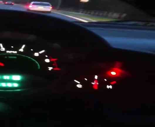

Above the temp gauge there is a little red round light flickering.
Its a little dot like maybe for factory security??
Its randomly coming on and off, what the hell is it?
Thanks,
Mat

That light is the "SKIM" light and it shouldnt be coming on while driving down the road... could be an issue with the WCM/SKIM module..or could be an issue inside the cluster...
UNLESS... someone wired a radio/CB/AMP etc etc in improperly

Mine does the same thing. It didn't start until after I had the computer flashed, before the warranty ran out, for the hot oil recall. I have half doors so I don't have the security system, power windows, or power locks so I don't think it has anything to do with the WCM. I took it back to the dealer and they couldn't find anything. I have checked the codes myself and have no error codes showing.
What I have noticed, is that it only does it when I have the heater running, which leads me to beleave it is a heat related electronics problem. Since electronics don't like heat and I can cut the heat off and after it cools down a little the light goes out & stays out.
I am going to tear the dash apart when warm weather returns to look for a problem with the heater or defroster duct work. I had another Jeep several years ago that the defroster duct was never installed onto the outlet for it on the heater box at the factory. So I am wondering if this is the same type situation.
Post up the why's and how's and lets put our heads together and see if we can find a solution for this PIA.

Anyone discover a fix for this problem.
I seem to have this exact problem. The red sentry light and "low tire" light keep coming on randomly on my 2009 Jeep Wrangler Sahara. The local Jeep dealer has checked all tire pressure, tire sensors, modules, recalibrated all sensors and modules twice, & even went as far as replacing the gauge cluster. None of this has worked, I still get those two lights coming on randomly for a few seconds then they shut off. I've tried a procal which seemed to get rid of the tire warning, however the red sentry light still goes off. Does anyone know what the hell might be going on or any ideas. The jeep only has 33k on it. Any help would be greatly appreciated.

Have had this same problem for quite some time but has gotten considerably worse in last two weeks. 2 local service departments had no idea and had never heard of this problem before. Sometimes light would come on up to 15 times a day. Only way I could get it to stop was to turn off the rig and start it up again, this would delay it for about a half hour. Finally decided to try my other key, and red light did not come on once today. Now need to find out if key is going bad? Or could the battery in fob have anything to do with it?

I had several lights on my dash flash while driving and the dealer thought it was odd but I had no codes.
I started finding on other forums folks with the same issue. Turns out if you have loose battery connections or your battery is dying iit will cause your dash lights to randomly flash.
My battery was going so I got a new one and now have no issues.
The cable ends seem to be prety crappy when it comes to staying tight as well as I also had a loose neg end and it wouldn't tighten up completely. It was snug but could still be moved by hand.

I am wondering if it has something to do with a head light being out? Mine flickered while driving last Tuesday or Wedneday and Thursday night I noticed I had a head light out, replaced the head lamp and the light has not flickered since...

I agree with Robbie on the TMPS issue , But what I found with a problem in regards to the security (red ) indicator is ; the person that owns the JK would open the door using the key ( for reasons unknown ) and set off the alarm , She shut it off then with the key fob . But the red light showed up , OK , what I found some are set up to indicate a history of tamper indication by showing that light as an attempt to unauthorized entry . For some reason mine is not set up like that but hers was . What I ended up doing was installing a new battery in the Key fob and unhooking the battery for an hour , to reset the system that I had been messing with for the morning . Try It , Good Luck .
