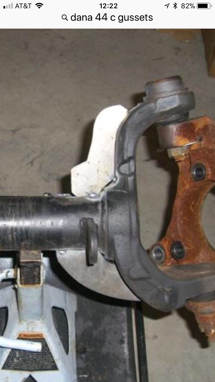

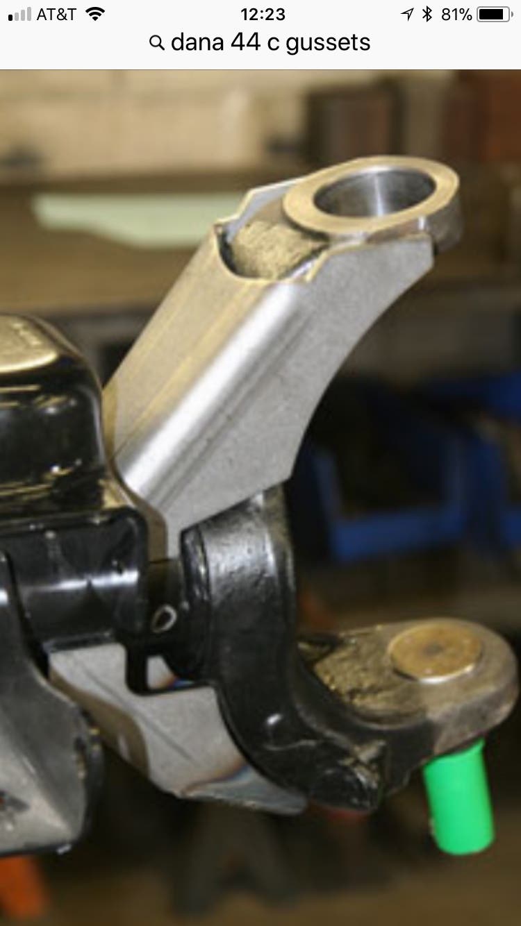

This sounds like an inexpensive but important “upgrade”.
Although I’m seeing many brands, I’m really only seeing 2 distinct “styles”.
1) solid plate steel
2) bent sheet steel
I’m not necessarily asking about “brand names” but I would love to hear opinions and experiences with each style.
As always, any and all input will be greatly appreciated.
Thanks
#2 ·
The first style, as made by Teraflex, Rock Krawler etc... definitely do the job. With these you don't have to remove the ball joints when welding them on, makes for a much easier/quicker process. I personally run the RK versions.
The other style, Artec, Synergy etc... is definitely stronger when it comes to the lateral stability of the inner c. Although 99% of the inner c failures happen when the c gets spread open straight up. They'll both do the job, it's just a matter of if you want to remove the ball joints/weld extremely slowly to keep the joints cool.

I waited until by balljoints were shot, then sleeved and did C- gussets at the same time, I used the second pic style,
Forgot who makes them, Haven't bent them yet, running 37" Treps Dana 44. I did bend my stock flanges in the rear, then went with 10 Factory rear axles, they've been in for 3 years, so far,so good.
