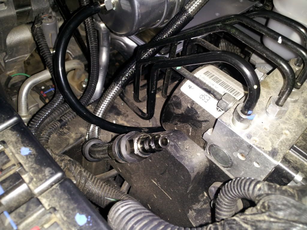

I was sporting a Q Industries MV-50 for the last eight or nine years. When I reconfigured the subwoofer in the back of my two door, I had no room for the compressor so I decided to hard mount it under the hood. As luck would have it, the compressor would meet its demise after trying to remove the portable carry handle on it. So I ordered up a Viair 400h to replace it, here is the outcome.
The 50.00 dollar brake booster mounting bracket.
The bracket was too close to the brake lines for comfort.
Finished product - Wrapped the leader in nylon braid, remote mounted inlet filter.
Factory installed type M quick coupler.
The ambush rubber cap - forgot it was there twice and hit myself with it testing it. LoL
Remote mounted filter under dash inside the cab. Compressor is pretty well isolated from weather now.
Soooo, this compressor is fast! The fill time from 12-30 psi per tire on the stock 32's was a minute and a half. Way better than my MV-50 for sure, and this thing is way more quiet. So far I am pretty pleased with this and I have around 240 dollars into this setup which is decent for the outcome. Can't wait to use this out on the trail, I love the fact that I don't have to do anything more than connect a hose and flip a switch now!

Thank you Brother! The end game will be adding an extension bracket, manifold, pressure switch, tank, and air chucks front and rear. For now, i'm just grateful to be able to air down and back up again QUICKLY without having to drag out the red buzzbomb and wait for 20 minutes while everyone else is already aired up and getting ready to leave. Frickin Powertanks! :thefinger: It will be awesome when I have the tank and air chucks front and rear, I have always wanted that set up since I owned the TJ and never got around to doing it.

Don't waste time with an air chuck at the back. I have one at the front and the back but now I only use the one in the front. Air hose is cheap enough to just get an extra couple of feet.
