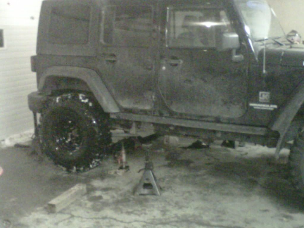

Well I got a good deal on a used LA kit and have started installing it on my Jeep. This weekend I got the rear in and now it just needs to be torqued.
Anyone else running this lift and can tell me what length they set the upper arms at?
Sorry for the cell phone pics
Here is my Jeep as it sat before this weekend
And here we go
