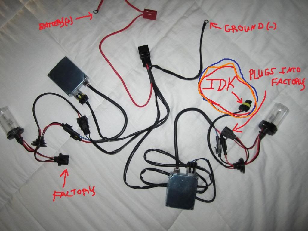

Hey got a set of H13 6K HIDs plug and play for the jeep but they arent working and i have a extra male plug for some reason, from the relay thiers 3 connections a male and female for the one light and only a male for the other and thats where its screwed up, i have all the connections correct positive to positive, negative to negative, grounded to bare metal and also tried the (-) on battery and so on. when i turn the lights on the relay goes crazy and starts buzzing and my passenger flickers and idk why and im still wondering why my one male plug isnt into anything, ive tried calling the place where i got them and they have the shitest service ever so any help would be great guys bc i have no electrical skills
heres a picture

My memory's foggy because I changed my lights out a while ago, but I used a different set up. I assume the female connections are going in to the factory Driver and Passenger side headlight hookups, no? If that's the case, that male plug goes into the headlight harness also on the passenger side right by the TIPM. You have to seperate the connection, pry off the cover, and it plugs right in. I REALLY wish I could explain this better and if the rain stops soon, I'll grab you some pics.

You've ordered the wrong set. What you need is a H13-3(9008) Bi-Xenon (Dual Beam) HID conversion kit. What you have will only give you low beam, no high.

they are the bixenon light.

You're trying to run an illegal cheap retrofit on a PWM circuit.
Can you return it and buy something safe and legal?
