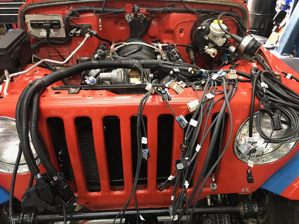

We have a conversion harness for the Jeep TJ-LJ that will allow you to install a GEN4 GM LS - 6L80E into your Jeep with all the factory dash and AC still working.
We did a 05 TJ Rubi back in August 2018 with a LS3 430HP and a 6 speed auto 6L80E and it turned out fantastic. One of the best driving TJ's I have ever driven.
Our plan is to build from this harness and eventually offer a GEN4 manual trans option as well as a GEN3 Auto and Manual option.

So...
in your pictures it shows GM PCM. Where is the Chrysler PCM. I’m in process of getting a L83 with 6l80 and parts needed for mounting P/S pump. Still wondering why the Chrysler PCM is needed. I planned on new bezel and gauges like AutoMeter or similar sells Lokar shifter...
List goes on. Just getting motor and then removing I6. I understand I can’t use Rubicon 4-1 T case either.
