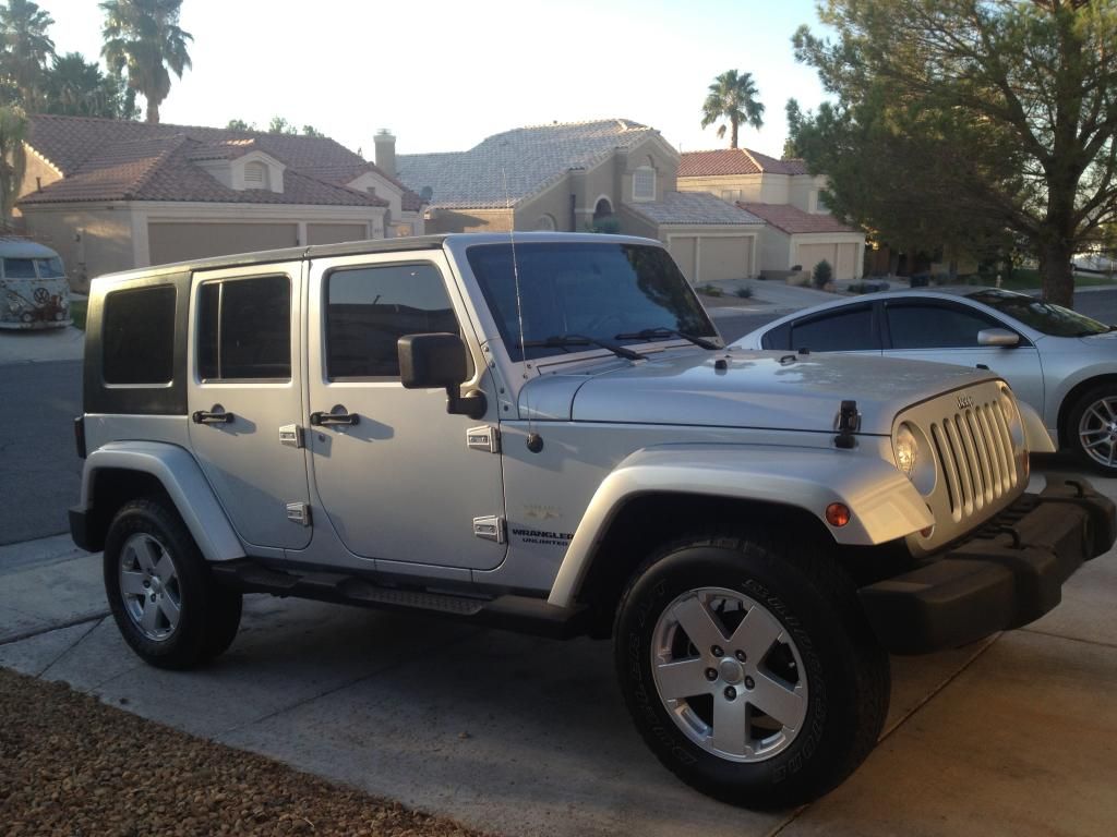

I will be posting up pics of my 2007 JKU build over the next few days. I picked up a 2007 silver JKU Sahara on oct 28 2013. She had 98500 miles on her and was completly stock and absolutely flawless (except the mileage). Prior owner used it to commute with. Here is a short list of mods that were planned. I wanted to keep it clean simple and reliable to wheel any trail I wanted.
4" Currie short arm
Rock jock 70's front and rear
Motech LS3/6L80/Atlas 3.0 swap
Coast drivelines
PSC aluminum fenders
PSC brawler rockers
Gen right aluminum bumpers
Warn powerplant winch
Trucklite LED headlights
40" nitto's on raceline beadlocks
Full custom weld in roll cage
Artec full aluminum skid plates with crossmember
Black magic big brake kit
Will be doing mini write ups for each stage. I planned on doing all of the work in my or a buddies garage, with the exception of the Mo tech swap. Leave that to the guys who specialize in it. Stay tuned! A pic of the day I brought it home
