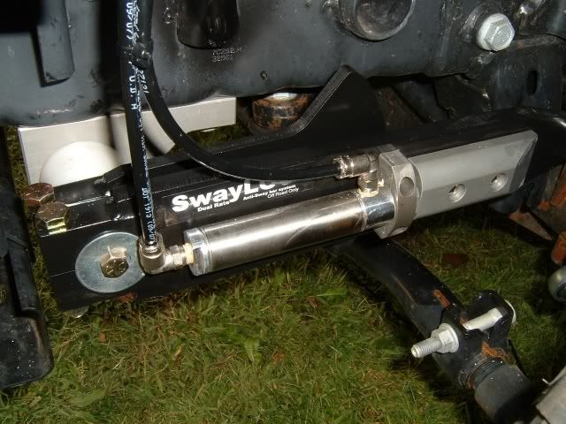

So far I installed Off Road Only's SwayLOC and on board air system.
They both were easy to install and work awesome!
Heres a few pics of the SwayLOC....

Those ORO swaylocs are cool, but personally I think I'd prefer the Teraflex dual rate. Swaybar when on,torsion bar when off.
the swy locs are a dual rate that what i am puting on instead of my antirocks
Yup, the SwayLOC is dual rate!
It even says "dual rate" on the arms that are visible on 2 of the 4 pics I posted :D

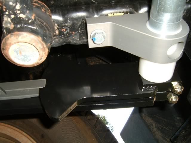

The long outer bar is attached to the torsion bar.
The inner arm with the notch in it is attached to the outer swaybar.
When locked together its a solid swaybar.
When its unlocked its a torsion bar.
You can get the air operated version like I have or ORO also makes one with a manual latch on it.
Heres a pic that shows what I explained above.
How are your clearances? Do the ends of the arms hit the shock mounting cup?
