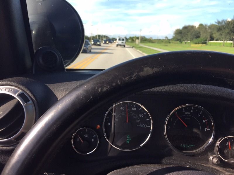

Hey Guys, my leather steering wheel on my 2011 is starting to degrade. It seems like the outer layer of leather which is glossy/smooth is peeling off and spreading. Is there anything that can be done to condition or recondition a steering wheel back to a uniform finish?
Look dead center of this pic you can see what I'm talking about...

looks like you need gas.....:gluging:.uh thats good question kinda been having the same problem...ive used leather conditioner and wiped the steering wheel with a rag. seems to have slowed it down to a point but its not a ''fix''

I have used "Bucket O'Towels" for cleaning dirt off ; it has a lot of natural cleaning solvents/ingredients (?) but one of it's best features is it also has lanolin for moisturizing hands but we know that leather benefit from it, as well. I will inform you that I after I got the '11 , I initially cleaned the crap out of the leather wheel ;cleaned it first w/ a Magic Eraser Mr.Clean thingy &t hen - as w/ any leather product I own - I totally salved-it down with high grade MinkOil ( just like ya do a baseball glove or hunting boots) for the initial coat of protection. I have a few nics and nail-clench-"dig-ins"( I am not joking)but none of the drying out, fading/peeling which you've now encountered. The best you can do now that the surface is broken is try to re-press the surface and then refinish the leather*. there are you tube videos on that.
<edit: when I say ,"to re-press the surface and then refinish the leather" , it is obvious that I am a utterly useless resource for leather wheel restoration processes as that may be backwards sggted way. I simply meant you will have to clean, finding a way to resmooth that broken part of the smoothed hide and then seal it. I would have to look that up if I were doing it-j3ff3ry>

Ok thanks for the input! I now realize I probably should have been treating the leather of the wheel with something the last few years, although I don't know what.
I also don't know what is the best way to try and save it I'll have to do some more googling I guess. I don't want to just get a cover and slap it on I would like to try and salvage it as best I can...

Maybe a good leather conditioner may help. Something used on saddles.
^^^This. I have used the King Ranch conditioner on all my leather since it was recommended to me after wife bought a King Ranch truck. It works great.

If it's not worn through the leather then you can refinish it easily. SEM Color Coat will work, even the Duplicolor Leather and Vinyl will work but I'd spring for the SEM. Sand it really smooth in that spot, down to 400 or 600 grit sandpaper, then mask and spray with SEM. Easier if the wheel is not in the vehicle so you can get to both sides ... mount it with a bolt so it's vertical and you can walk around it spraying.
After it dries all the way you might have to sand a little more if there's a blemish where the rough spot was, and spray a little more. Repeat until it looks right.
