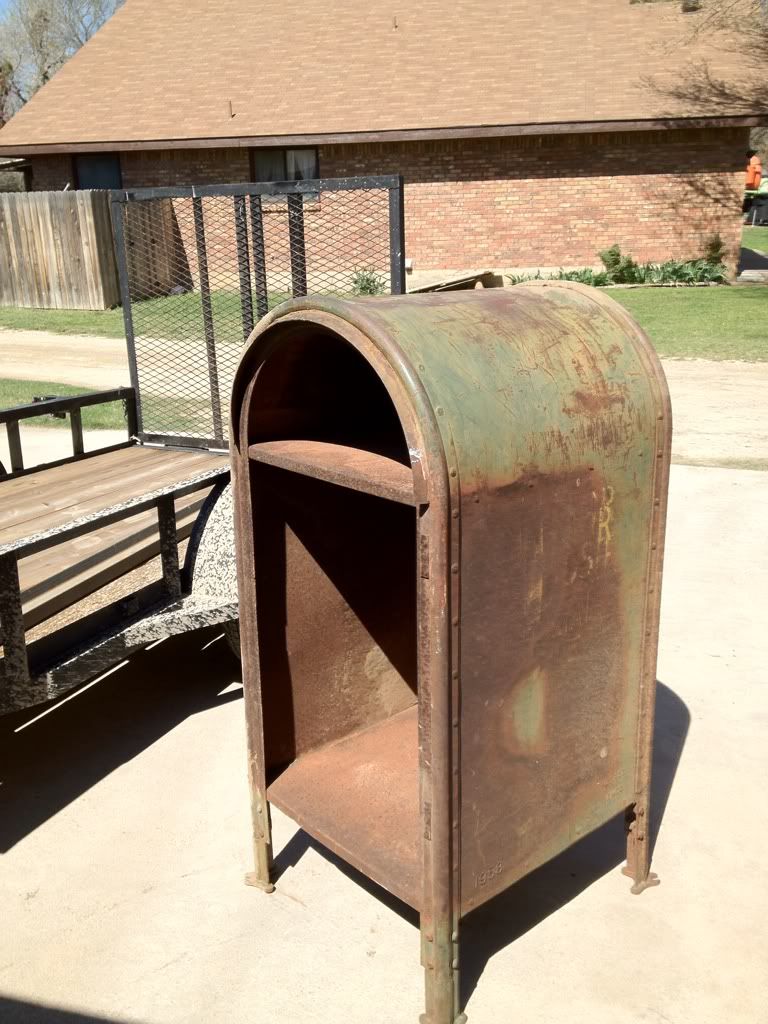

I found this old 1958 mailbox at the local metal scrapyard. It was faded green with yellow letters on it but is unreadable. I think it may have been on a military base.??? I have and idea to turn it into a smoker with two racks in the bottom section and an oven for pizzas/bread in the top area. I just need to make a door with vents and a stack that goes through the top section sealed off to make it work. A little paint and I will have a custom smoker.
Any other ideas or suggestions from all you grilling/smoking connoisseurs?

I think i'd take out that top shelf. The curve of that thing is about perfect to aid in convection. If you want a solid shelf for pizzas, I'd make it removable. I think I'd also make an upper and lower door if you want to go the extra work. It will allow you to stoke the fire at the bottom while allowing heat at the top to stay in.

Yes, I intend to make two doors. The bottom rectangle will open to the right and the top C shape will drop down. I will just use small chains to let it drop level with the shelf.

I'd leave the top shelf, but maybe cut the center out of it and replace with expanded metal for baked potatoes, corn on the cob, grilled onions and so on.

Yes, I will make my shelves in the bottom with angle iron at various heights so I can vary the distance from the fire box. I will use removable expanded metal racks to slide in for smoking or grilling. I think I will make the firebox in the bottom removable also for easier clean out. If I make the firebox removable I can move the firebox up in the bottom section to make the oven area easier to heat. A thermometer in each section to keep track of things too.
I think also that I can build a smoke stack on the side that looks like a envelope drop. To keep the mailbox look. I might try to find some old mailbox pics to see how they used to paint them.
That works.
