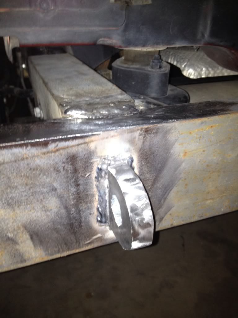

I made a trip to the metal scrap yard to see if they had anything I could buy to make a rear bumper. I will make a tire carrier later since I'm trying to stay on a budget. The tire carrier will cover most of the gap between the bumper and the tailgate of the Jeep. Forty-five dollars later I have some heavy metal to make a rear bumper. A 5 inch C channel- bumper, 3/4" plate for the recovery point, and some heavy 5 inch angle iron for the frame mount. I took the recovery tabs notched and into the frame. I will run some grade 8 bolts through the recovery plate and the frame. Saw this on someone's build a while back. Nothing fancy but will get the job done. I may build a receiver into it later but for now I'm happy. I am waiting on some grade 8 bolts to come in tomorrow to finish the final installation.

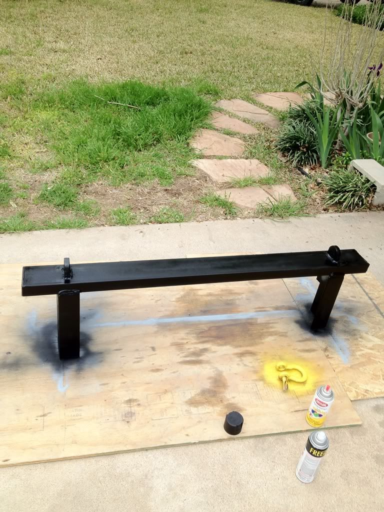

Paint 2 coats of primer and then truck bedliner

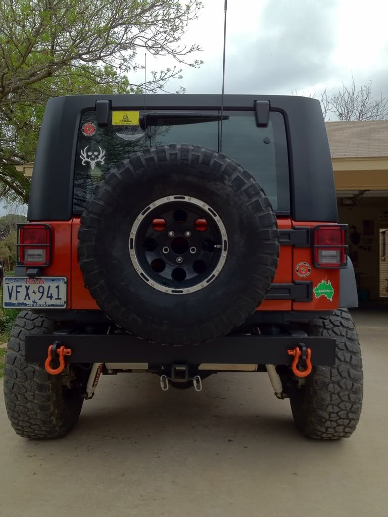

And done:62 pounds
extra bolts through the frame and larger bolt through the recovery tab and frame
