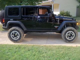

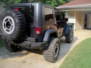

Moving to Hawaii & need to know all what I need to pass Hawaii Safety Inspection & Recon. I am Military & vehicle is currently registered in VA.
This is my Jeep:

just add mud flaps and "garden trim" from walmart to extend your factory fenders out over the tires. If they drop a ruler down the furthest edge of the fender to the tire and measure 1" or more of tread sticking out they will fail you on the "RECON".

2. Put mud flaps and garden trim on your fenders to extend the fenders over your tire tread and ensure they cannot see half of the height of your tire as looking from the back of the vehicle. I have the trim and mudflaps to help you out when you get here....I loan them to everyone to help get through RECON then get them back for my safety inspections each year. hasn't been an issue for others to redo safety each year without it but I just put them on because I am one of those guys who would find MURPHY and fail just because it's me! LOL

If you are still stock you will not have to get a RECON done. RECON is only for those who have lifted/lowered their vehicles from stock, changed tire sizes or wheel sizes from stock. Everything else they pretty much dont care about as long as there are no add-on lights that show color (such as blue or yellow).
