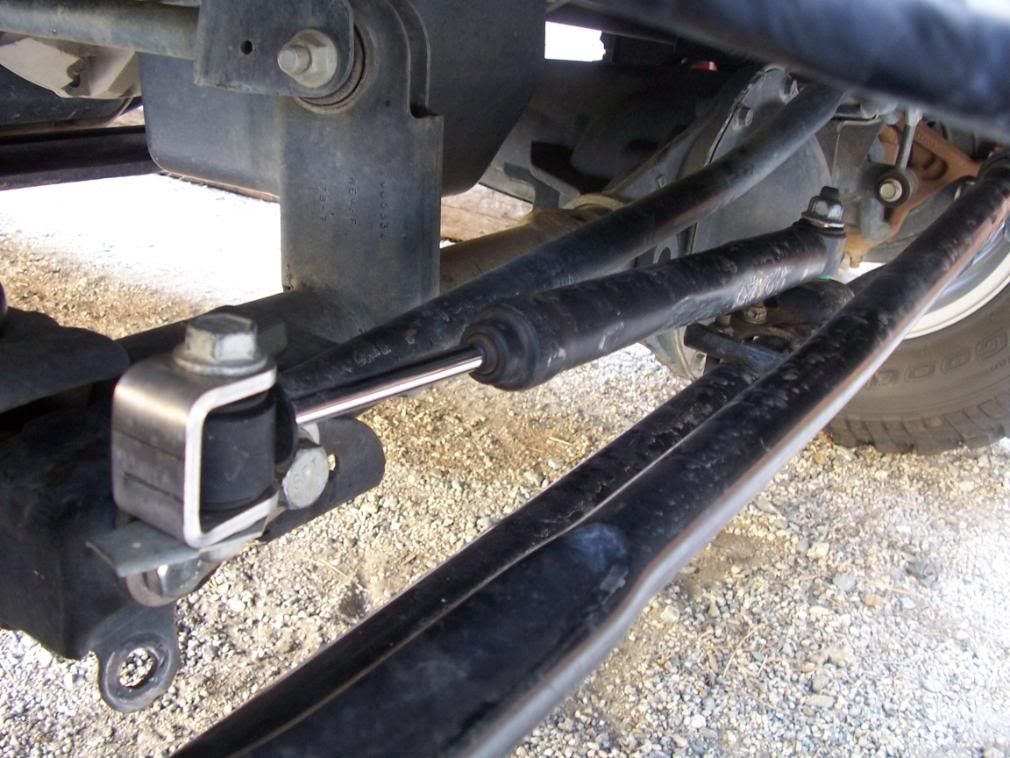

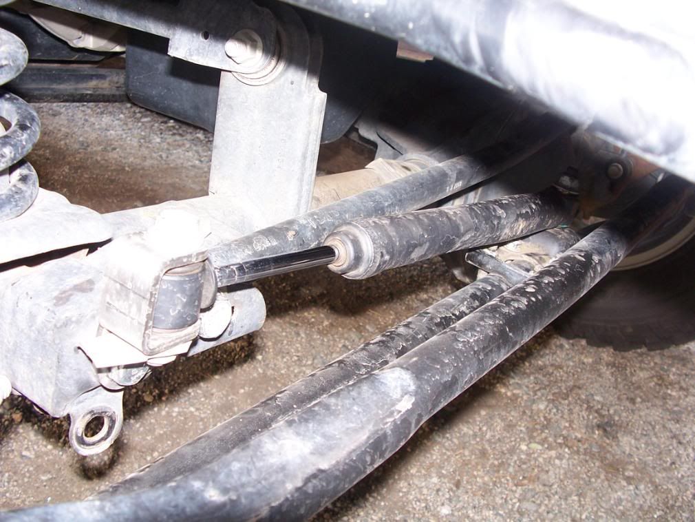

Here's some pictures of the new Woods Steering Stabilizer Relocation Bracket. Thanks Woods!!!!! You are the best!

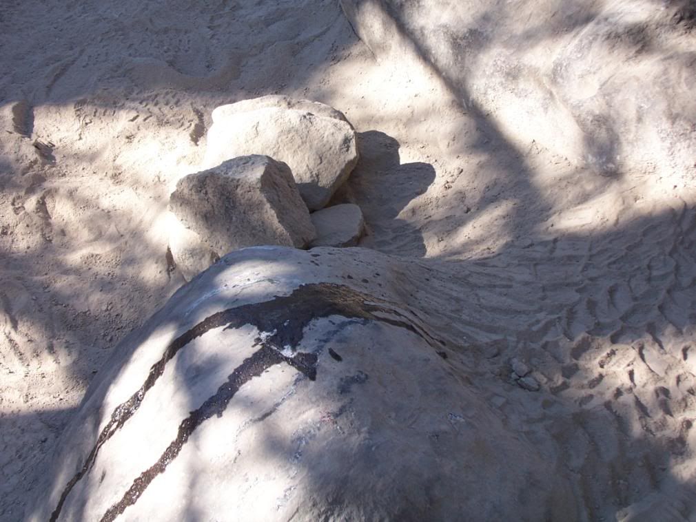

Everyone needs one of these or you will end up like this.....

Dont that stabilizer need some type of fluid in it? reminds me of a "ripper" (a deep fried hotdog that starts to split open/ inside out...lol. Thanks for posting the Woods pics. IF POSSIBLE...can you post results of turning steering wheel full left/ full right during full droop pass side/ full droop drive side? any contacting or binding issues? Just curious...

Shouldn't be, quite a few people are running stabilizers in that position with no issue. I have a Fox one in a similar position with no issues, and it's a big stabilizer.
There is some possible binding. If you do not have bump stops and the passenger side is fully compressed, you could hit the frame with the top of the shock bolt. And if you have a really fat steering stabilizer, you could end up with some rubbing on the track bar or tie rod. The only shock that I've seen that really causes any problems is the superlift SS. It has a very large diameter.
BTW, I've never had one of these returned, so I'm guessing that most folks are happy with it.

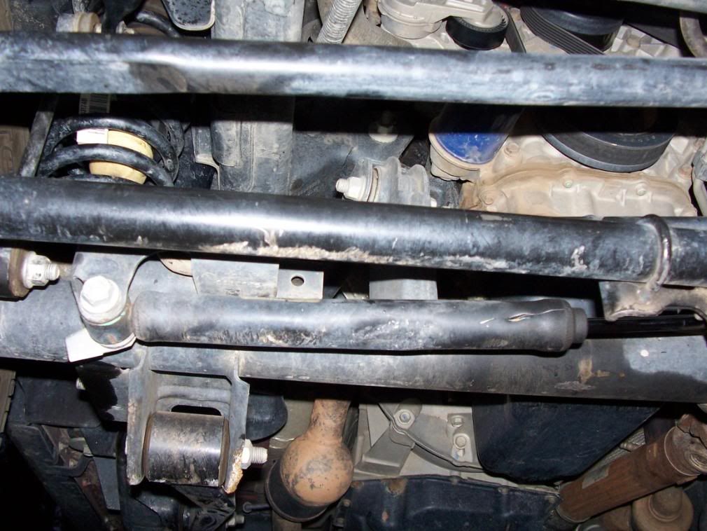

Does that steering stabilizer actually do anything? It looks so beat up.
Lol thats what i thougth too,but it still works,when i hit it on the rock it pissed out the front seal,but it still worked,so i put it back on,lol .got a friend at a Dealer who's going to warranty it for me.:innocent:
