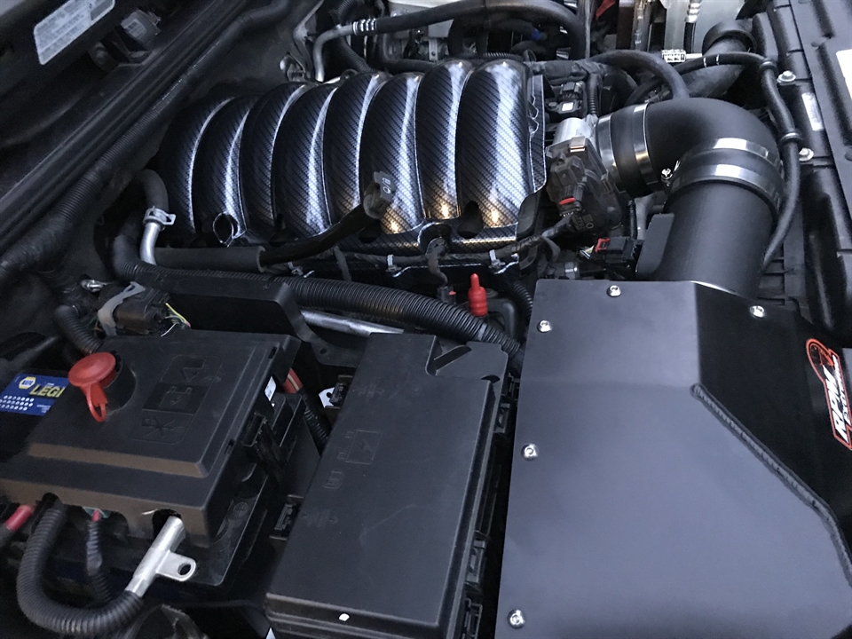

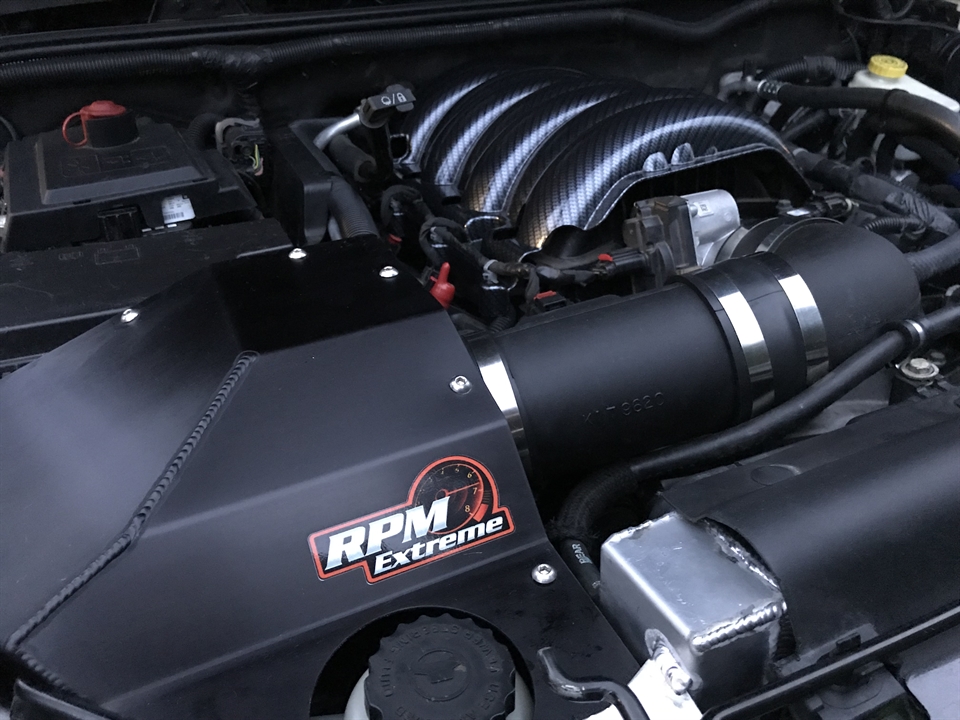

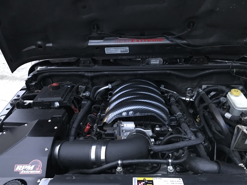

For now here are a few teaser pics to get things going.
This one shown is our original prototype harness, our production harness will be just like our GEN4 and will tuck in behind the engine and be much less bulky.
Its actually a lot of engine to fit under the hood with all the GM covers in place.

If you pull the factory plastic intake and coil covers it makes fitment a little easier. The only real areas you will notice the size difference is RH cylinder head to firewall and upper intake cover to cowl. Everything else fits great.
