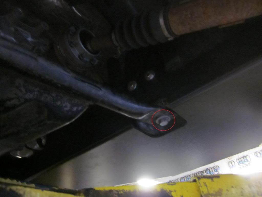

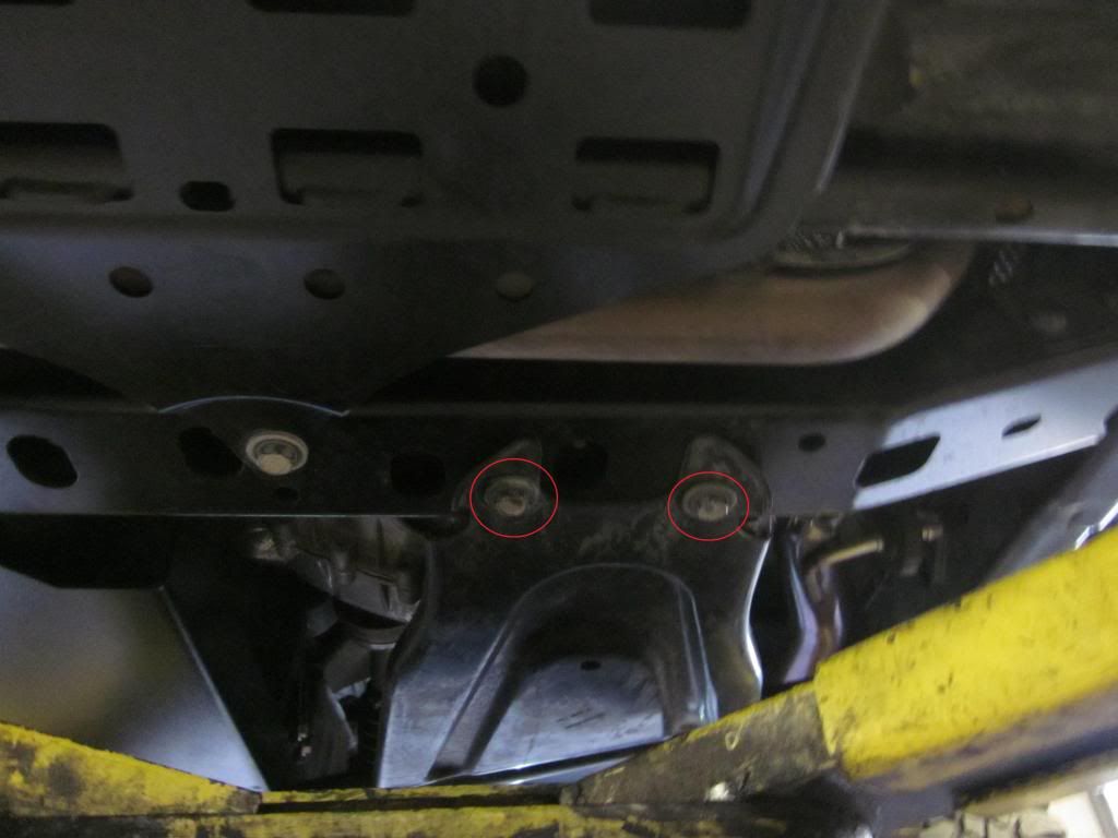

Remove the two outer 18mm bolts from cross member

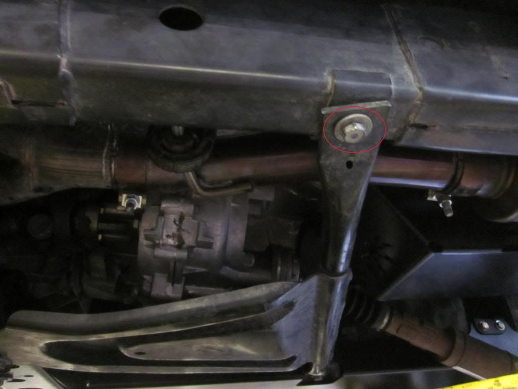

Remove the 18mm outer frame bolt

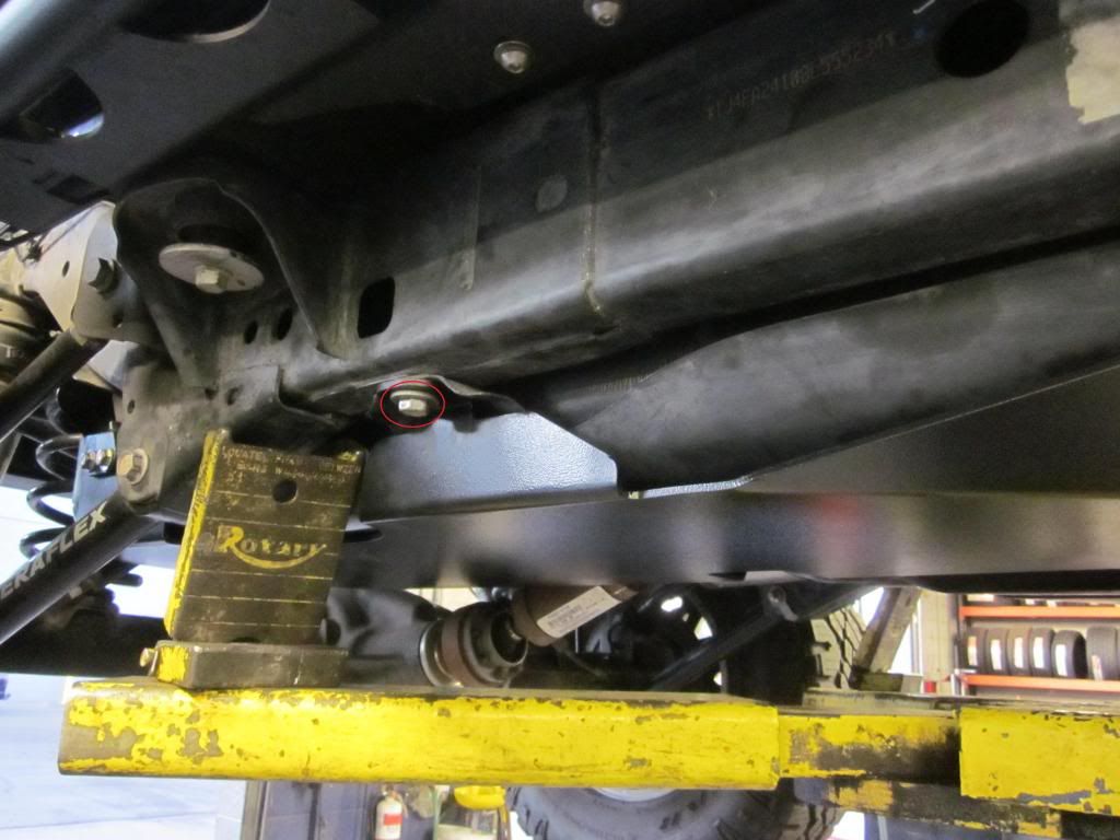

Raise the Rough Country Skid up to match the two outer holes where you just pulled the two 18mm bolts from cross member at, and the one from rear outer frame. You will reuse the OEM bolts and hand tighten the bolts in place

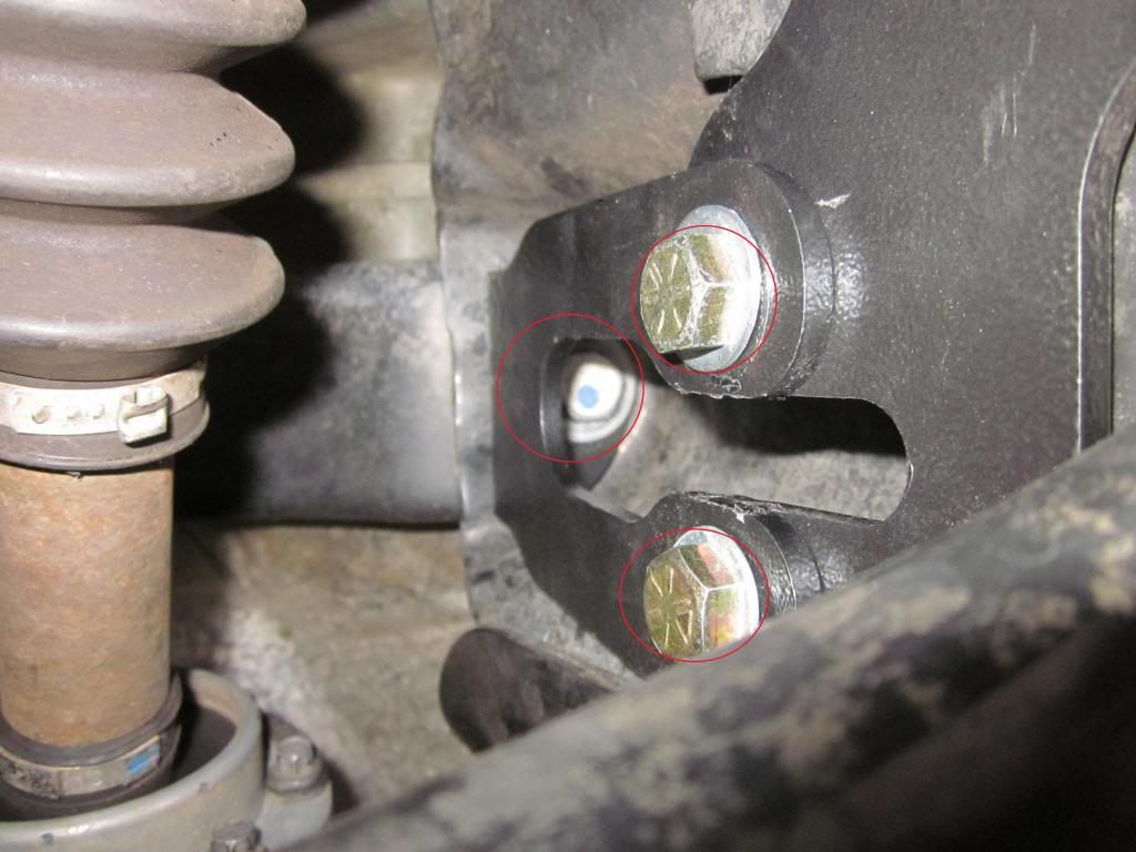

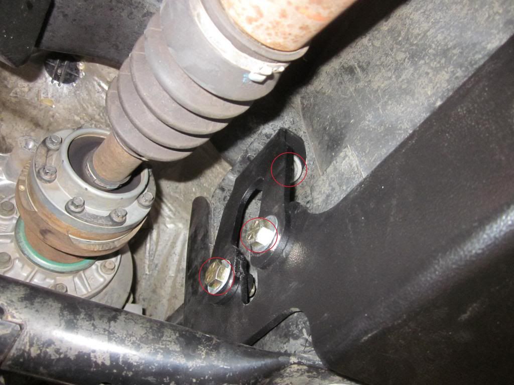

Remove the inside gas tank 18mm bolt an install the “U Shaped” middle hanger bracket. You will reuse the 18mm bolt you just used for top part of bracket and for lower part of bracket you will use the supplied 7/16”x 1” bolts and washers. When tightening down, just make sure all bolts are hand tightened for now with 18mm socket and 5/8” tool.

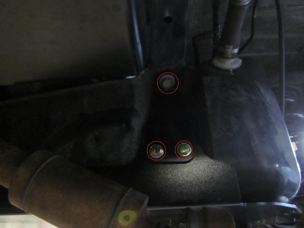

Remove the rear inner factory 18mm bolt and install the rear inside hanger bracket (hole in middle of bracket) You will reuse the 18mm bolt once again and the two 7/16”x 1” supplied bolts and washers for bottom two holes of bracket. When tightening down, just make sure all bolts are hand tightened for now with 18mm socket and 5/8” tool.

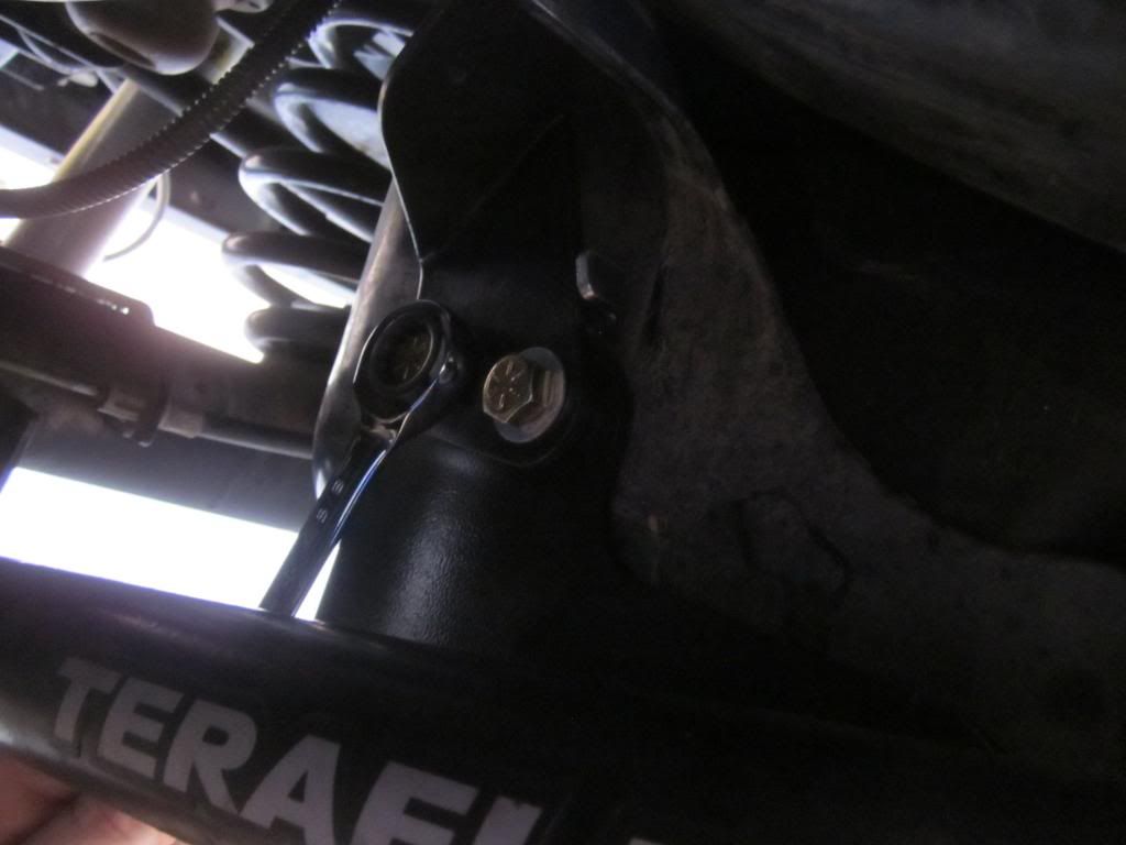

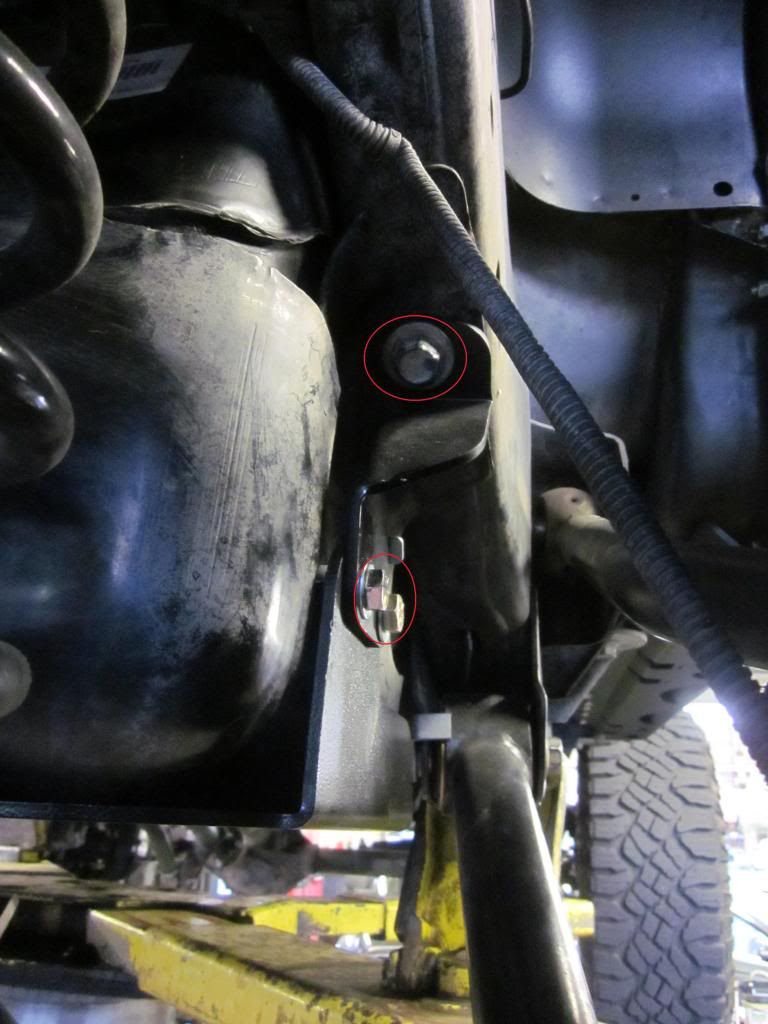

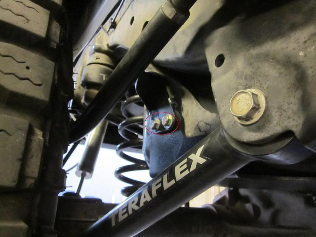

Remove the rear outside factory 18mm bolt. I found this location to be a little bit of a pain due to not having wheel pulled like in the Rough Country video. I used my 18mm socket with the long drive socket extension to get bolt out. Once you have the 18mm bolt removed, grab the rear outside bracket and hand tighten the 18mm bolt back in place with extension. Now that you have the bracket in place, grab the flag nut and place on back side of skid plate and insert your last two 7/16”x 1” bolts and washers. Hand tighten the 7/16”x1” bolts with your 5/8" Ratcheting Wrench.
