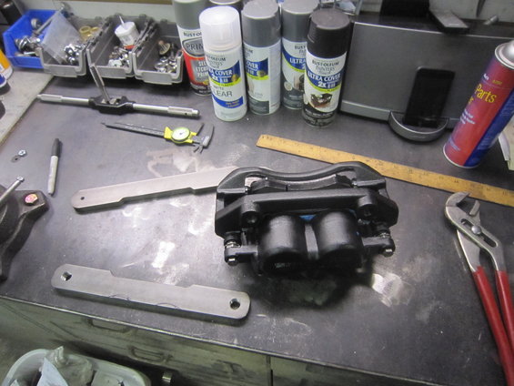

When I ran my 44, I had installed the Teraflex big brake kit and optional master cylinder. When I swapped to the RJ's, I still have the larger rotors but had to go back to the original single piston calipers. They do work pretty well but was curious about adapting a dual piston caliper with larger pads. Looked around at Napa and decided on these from an 08 Ram 1500 4x4.
Picked up so 1/2" thick bar stock and started roughing out the new mounting adapters.
Drilled and tapped. Had to get some longer bolts due to the mounting ears of the calipers being wider. Also had to reduce the size of the spacer to account for these.
All mounted up and compared to stock caliper
Nice pedal feel and great braking power. I don't have any scientific data to compare but "seat of pants" says well worth it.

It's the mounting ear seperation of the F450 outers that allows enough room for the adapter bracket. Pretty sure this won't work on 44/30's due to space limitations.
Those are the Napa part numbers I used.
RJ comes with 13.5 rotors.

Stopping is greatly improved but the peddle feel is the same. I am going to upgrade the master cylinder and see if this help. I am also going to see how much it would cost to get the bracket and the spacer machined if anyone is interested.

i got 10 sets made. let me know if any of you guys want a set. I only have the brackets, spacers, and the new grade8 bolts. you'll need to get your own calipers and pads. BTW. NAPA told my factory JK calipers and credited me $90!

i looked at the rear but it would be lot easier to get an entire new set of calipers and ebrake. also not all ram1500s have dual piston calipers.

the mountng point to the axles should work since they are mated to the cureie axles. what size rotors do you have? these brackets are designed to work with the 13.5" rotors from currie and the ram1500 calipers.
