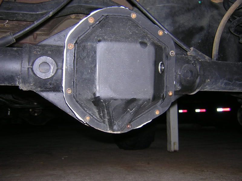

1/4 inch Diff cover
Just make ya one of these....1/4 inch thick, yea, that's what I'm talken bout...
Yea...Just make you some of those! Man those are sweet, Paul. You have got some skills. The welds look good, 1/4" steel, and the reinforcment on the bottom looks like the right idea to avoid impact damage. Very impressive. I'm going to go out to the garage tomorrow and snap my fingers and see what happens...lol
If you are going to wheel it, get used to diff leaks. The cover lip will get tweaked, and thus drip. It is a simple fix to put more rtf behind the cover but a pita. Look into a beefier cover or put a drip pan under the jeep.
