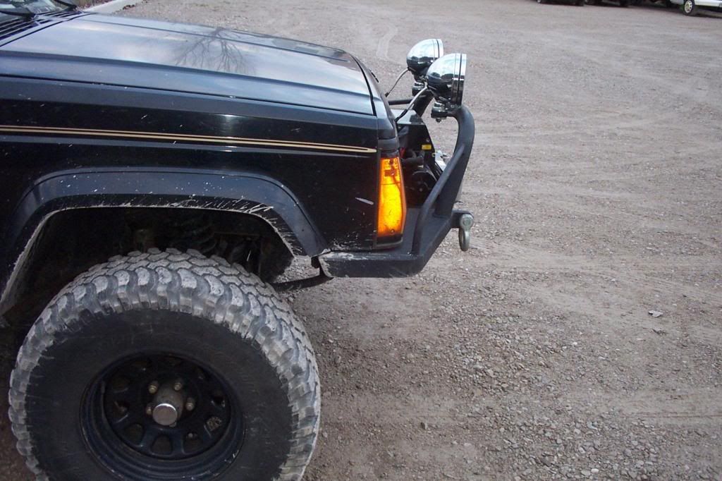

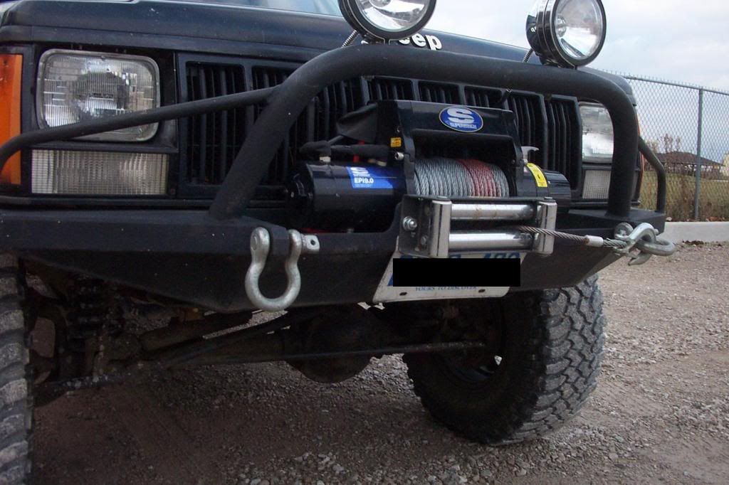

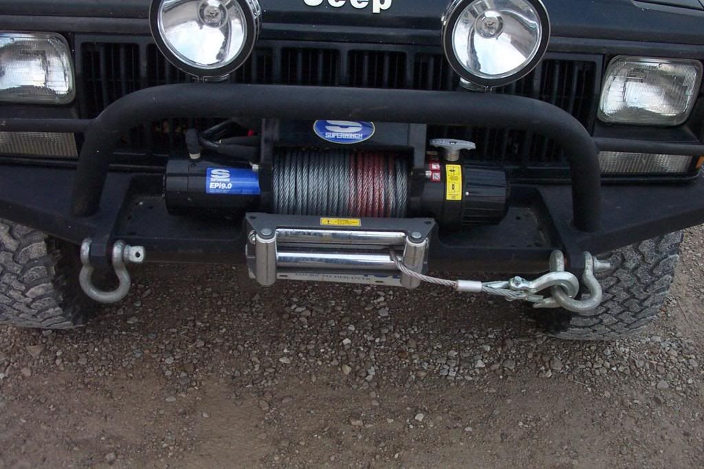

Hello everybody Im doing some research. A friend of mine has reciently lost his job. He has great fab and welding skills and has made a few custom bumpers. I need your opion if these are good enough to make a living at. I am doing this on his behalf since he is new to computers. Here are some example pics.
Thanks Ken

I like the lines....it works aesthetically at least.
Its hard to tell detail though, like how the welds are, how its engineered...or the finish, etc.
If you had some pics/descriptions of weld details, how its mounted, wall and plate thicknesses, etc...it would help.
:D
Personally, on the one shown for example, I'd want the light bars to be thicker, but angled so as not to block the headlight output...and I'm partial to hidden winch mounts, as the company has them stolen sometimes when it looks to easy.
:D
But - I do think the overall design approach at least looks professional. If the quality is there, he might have a shot.

I like it.. Wouldn't mind one of those on my JK.. Are You in Ontario?

Lines look decent, I'd recomend getting Winch to sink in lower if there is no obstruction with the factory frame. The guy's in the heat belt will not like the winch blocking so much of the grill.
The side bars are not proportionate and the paint is nt appealling for show. I realize it is not intended for show.
I'd recommend adding a little more height and seeing if he can add room for some fog lights that part of the bumper. I'm not sure if this is feasible for the model shown or common for this jeep.
I'm assuming the thickness is 1/4" steel but like TEEJ stated more specs on the bar and how it installs is critical. Need to believe the tow points are secured to something like the frame.

The bumper is really nice. Reminds me of the M.O.R.E. XJ bumper but just with a winch bar. The only problem with XJ owners is they have pretty shallow pockets. Not all, but seems like most do. I just wonder how much buisness there would be for a guy who relies mostly on the sales of that bumper. I think people out there would buy them, just maybe not enough to do as your only source of income, at least at first.
IONe question though. How are the shackle tabs mounted? I know one thing the XJ guys look for is they like to see the tab be an extension of the mounting bracket. BAsically so the bracket mountet on the unibody goes through the face of the bumper and has the hole for the shackle, no way to pull it out.
The other thing I know they look for is how many bolts are going through the unibody. HArd to tell but it looks freom the pictures like it only uses the two factory holes. I think he may find a couple more interested parties if it went back a little farther. XJ owners are not afraid to drill holes in thier rig. If it provided another two or three spots to drill bolts through for mounting that would help. The best though would be if it extended back far enough to cover the steering box bolts so it would be also acting as a steering box brace. On those old unibodies a lot of XJ guys have issues with the unibody metal breaking around the steering box from all the back and forth tourque
Anywaqy, sorry I wrote a book, just wanted to answer the question you posed...

Not bad. Better looking than alot out there with a name brand. Build a few and throw it up on ebay. Fastest way to sell for the quick $$$$$$$

That look works really well on Cherokees, but its not exactly out of the box or anything. JCR's design and a couple others are very similar, especially in how the terminate on the ends.
Unique no, but I like it regardless!
