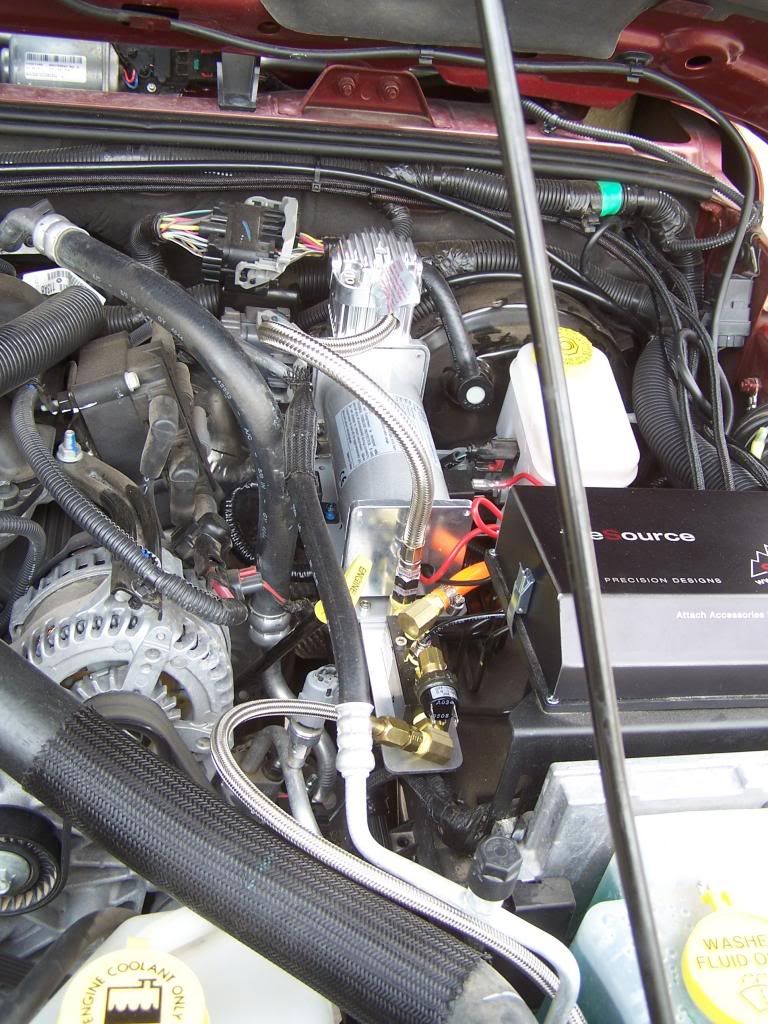

I mounted my primary manifold on an extension off of the compressor's mounting bracket. I have dual compressors so they go into the manifold which has a connection for the air gauge on the sPOD, the safety cutoff switch and then feeds out to the front and rear air tanks in the bumpers.

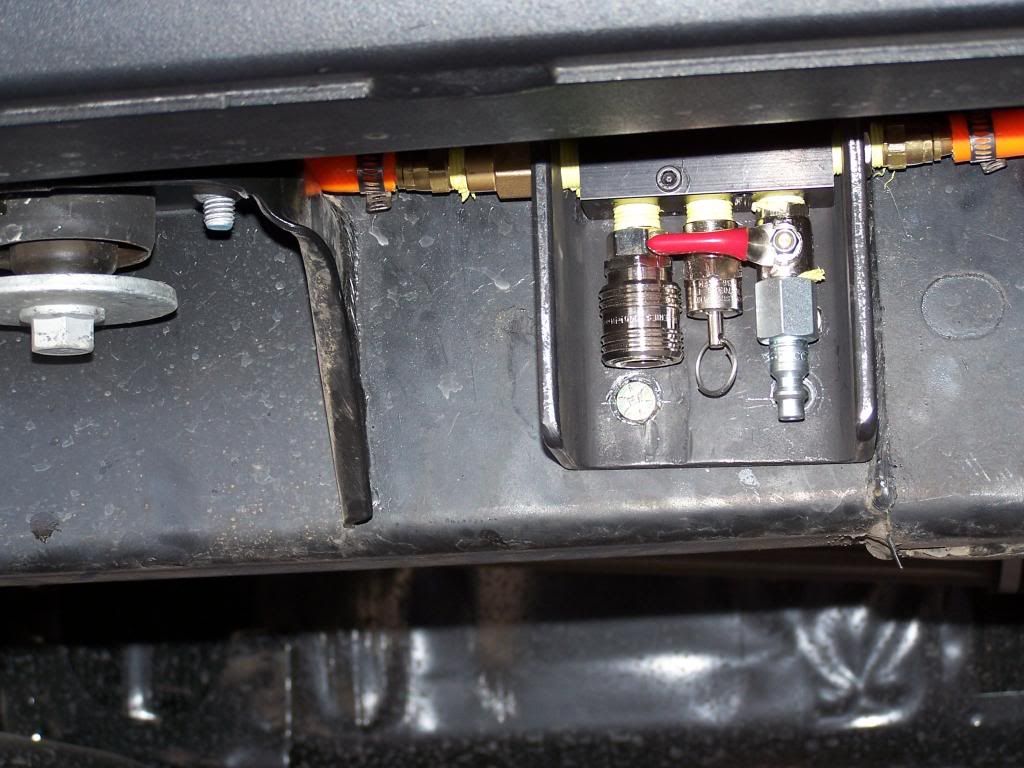

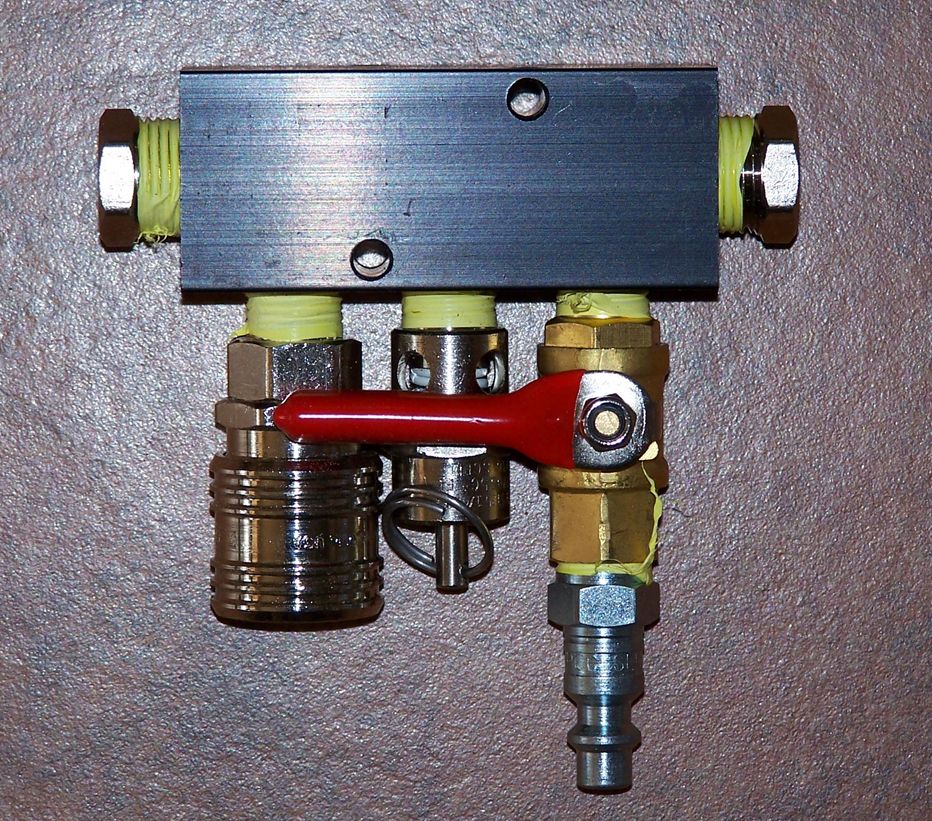

but I made another manifold that I mounted underneath on the driver's side frame between the front and rear doors.
