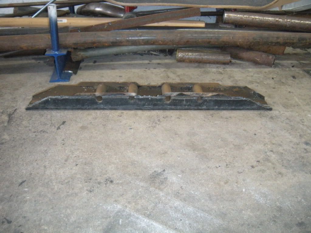

Started my rear bumper the other day.

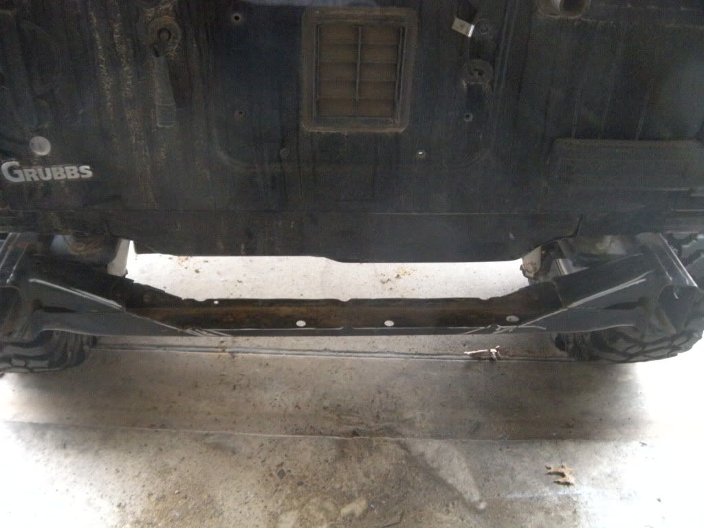

Chopped out a section of the rear cross member to make room for the winch.
If you wanted to know what the inside of your rear cross member looked like.
Welded in a strip of 3/16th to box in the cross member
Made some mounts out of 2x4 1/4 wall

Winch plate and the rest of the top tacked in place. Used a 1/4 plate for the winch, 3/16th on everything else.
Boxed in around the winch.
Receiver hitch welded in
Woulda got more done but ran out of welding wire. Hope to have some more done soon.
