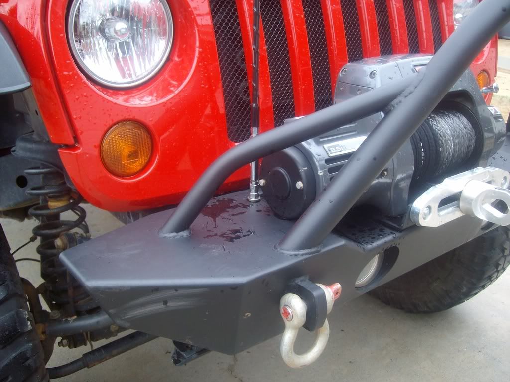

After busting several cb antennas while it was mounted inside the tag mount, I decided to relocate to a safer more functional spot. Moving my tag helped speed this relocation along.
I decided to mount the to the front bumper behind the stinger. This way it won't take too many hits on the base and also should have better performance do to not having to clear the roof. I was a little worried that I would look like one of those ham radio dudes, but I really like it.
What says you?

On the highway, it's better than before, which was already very good. If needed, I'll throw a 4 foot antenna on instead of a three foot, but I don't think I'll need to. It's a couple of inches lower than the roof right now.

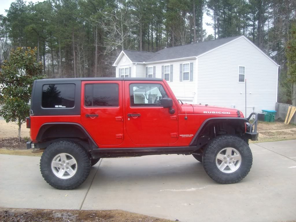

Here's the way it was before. Notice how vulnerable it is. Tree limbs rid the side of the Jeep and smack it. Also notice I don't have a fancy bumper yet. Granted, if it was tucked around behind the corner it would be better, but you still have to clear the roof more.

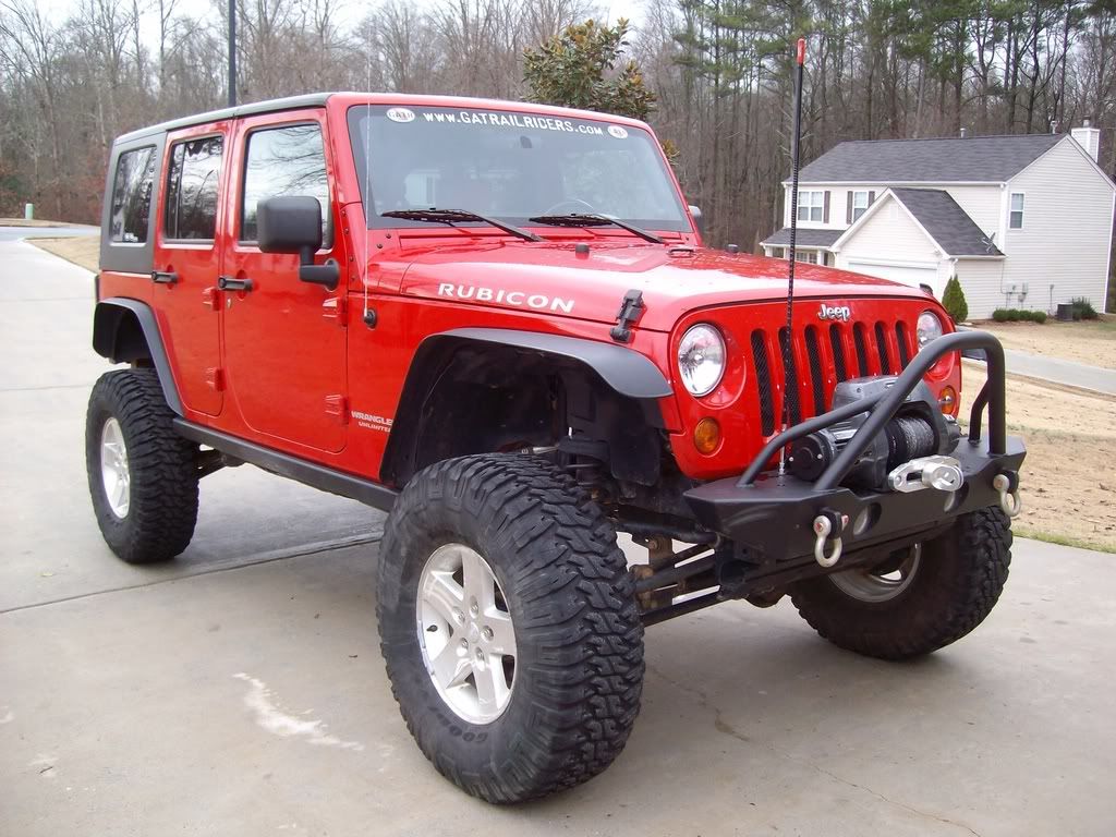

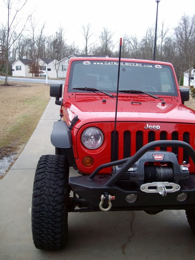

Many of my friends run antennas on the front like this. Most of them have XJ's, but they seem to work best there. I may put a 4 foot flexible k40 on the front like is in the picture above or even a stainless antenna like the one's below.

Yes, it should clear the top by about 6 to 12 inches with either top. Most of the time, you are riding in such close proximity with others, that you will be OK if it doesn't, but you want it to clear the roof for optimal performance. In the front I should have enough separation from the cabin, that I can run it a little lower. I'll probably still put a 4' antenna, which will extend about 9" over the top.

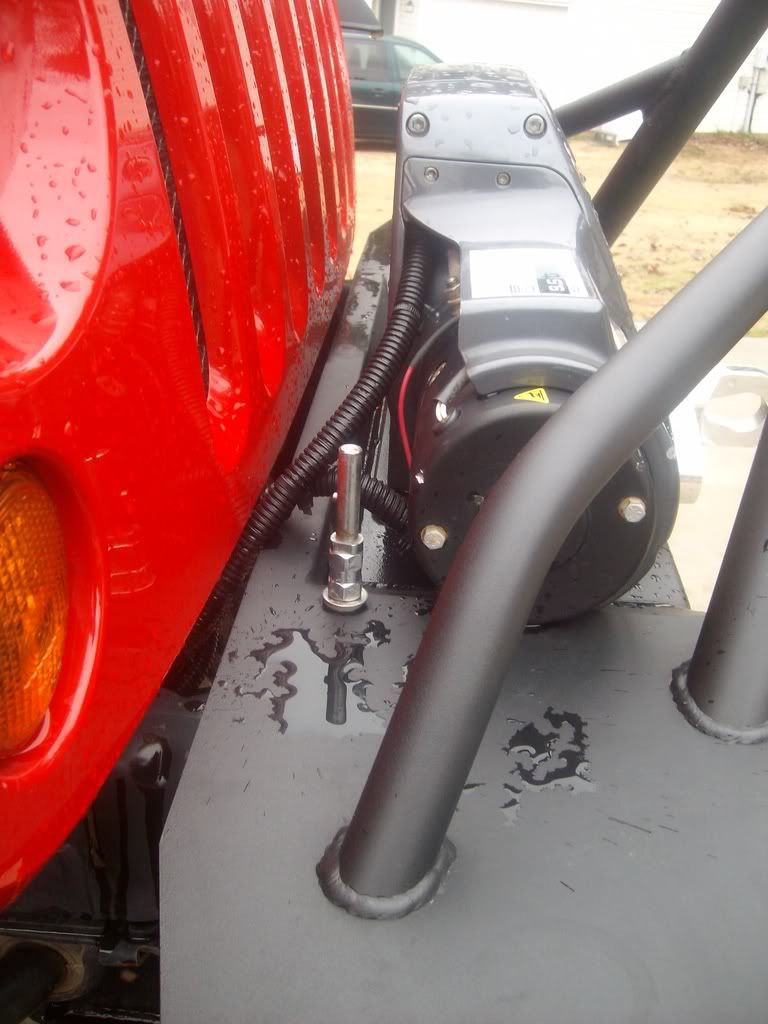

Actually no, I had motor noise when I had it mounted on the rear and grounded to the body. Now no motor noise at all with it tied into the frame. I routed the antenna wire through the firewall and down the extreme side of the hood on the driver's side.
I'm sure the winch will give it a jolt be mounted right next to the motor, but it does no matter what.
The SWR was 1.4 on channel 40 and 1.
You really don't notice the antenna after the first day of driving. I'm prolly gonna swapp to a 4 foot stainless whip which will be alot thinner. I can always just pop it off in a matter of seconds with the quick disco, but honestly it doesn't bug me at all. Just don't mount in directly in front of the headlight.
