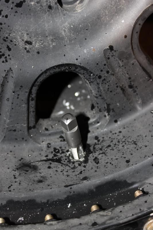

Once I had the 7/16" hole drilled, I tapped it using the 1/4" NPT tap. I placed a mark atop the tap so I could keep track of turns as I tapped the wheel.
Getting the tap centered is key. I dipped the tap into the cutting oil and then using the 7/16" wrench I tapped the wheel. Doing about 1.5 - 2 forward turns to .75 reverse turns, I went down until I could get the Monster Valve to screw almost completely on. Since the tap is tapered, you don't want to go too much because if you do, the threads will be too large and the Monster Valve won't seal. Once the Monster Valve was close to bottoming out, I pulled it back out, placed some blue Loctite on the threads and then tightened them down for good.
