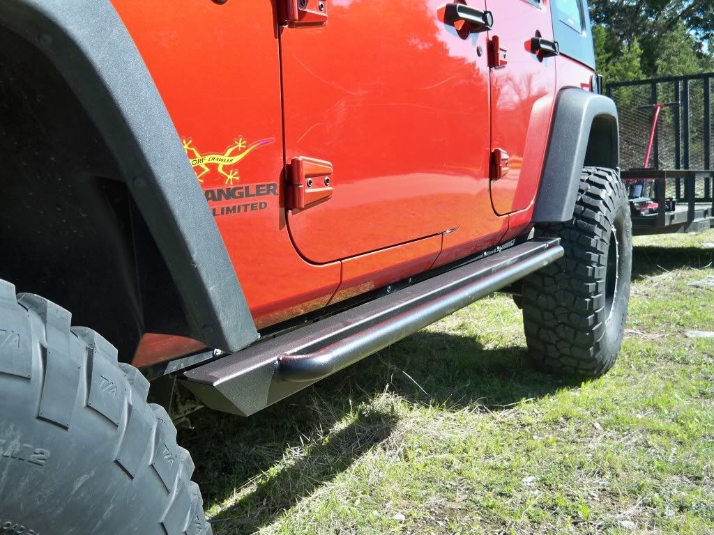

Homemade rock sliders

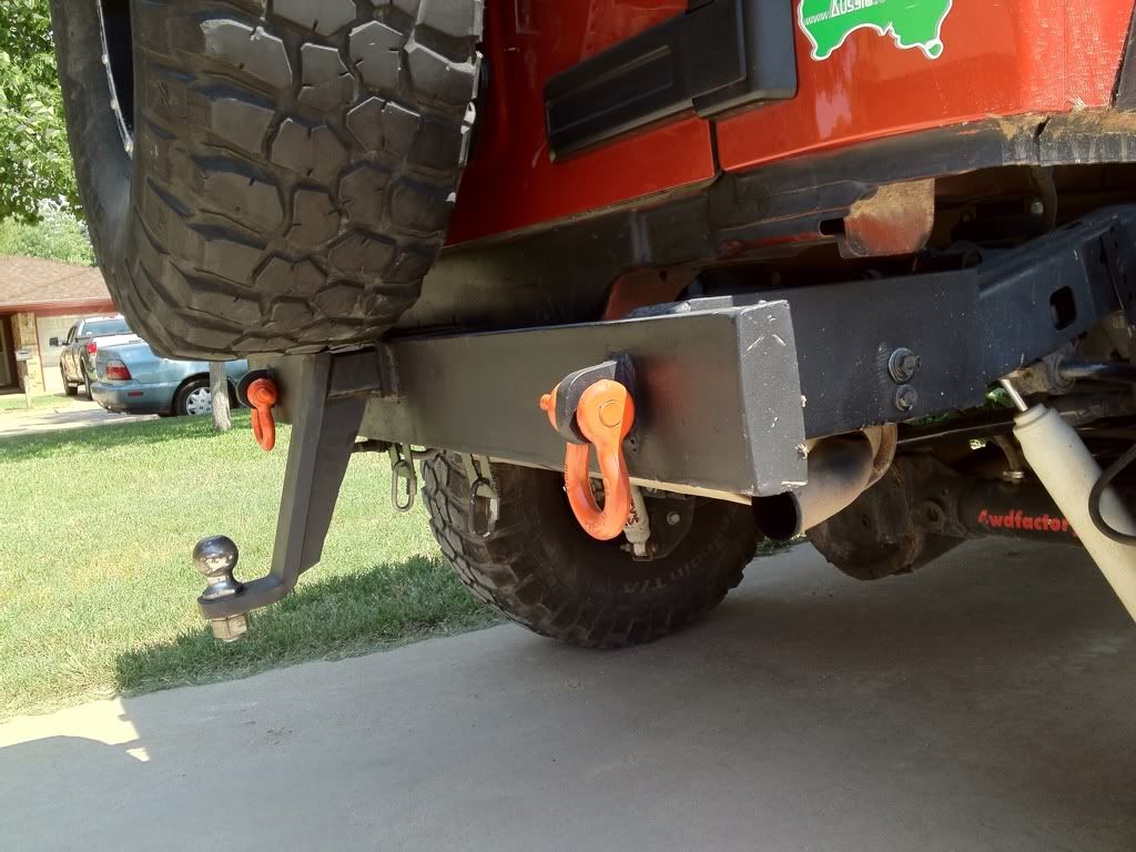

Homemade rear bumper

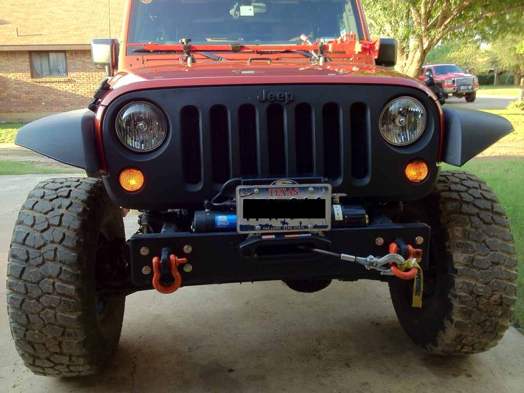

Homemade front bumper added my recovery tabs 7/21/12

Done- •Custom made *rock sliders Homebrew -3/17/10

Done- •*Homebrew Rear bumper with recovery points and built in receiver 3/14/12 (receiver 4/11/12) made drop in safety chain brackets and 4 pin wiring mount- Made with my son-priceless(5/4/12)

Done-•*Homebrew front bumper* (7/9/12) stinger later I think

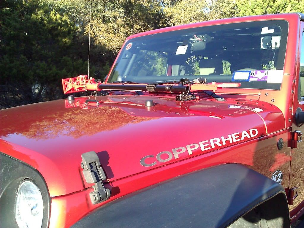

Warrior Products did a giveaway for January that I won!!!! They gave away winch rollers and a Hi-Lift Hood Mount. I won the hood mount. I did have to go out and buy a Hi-Lift. That's when my wife said, "You need a jack on your hood? I guess that is a good thing in the Jeep world." Yes, Honey it is! She is a good wife so she just says it's your Jeep do what you want. Flowers at work for Valentines is a winner guys!
I will say that it is a very well built mount. They put in a tube where the bolt goes through to strengthen the design. The bolts are allen heads to make a cleaner look and less available to remove than an adjustable wrench. I was surprised that the hood didn't seem that much heavier when you lift it. It is so far back on the hood it makes sense, but was still surprising considering how much the jack weighs. It took all of 10 minutes to install, so there is nothing technical. I used an extra spider ball loop to separate the handle from the jack to keep it secure and quiet. Normally I would have put my jack inside but it's a jack so if it needs some care I will take it off and hit it with some paint or oil to keep it functioning properly. I did also put a cable through the mount and jack to help keep it locked in place for someone less honest. I don't think my wiper spray will clear the mount, so I will need to get a generic sprayer at the auto store to make it reach the windshield. I might actually be able to improve the spray pattern. I don't use it much so it's not that critical to me.

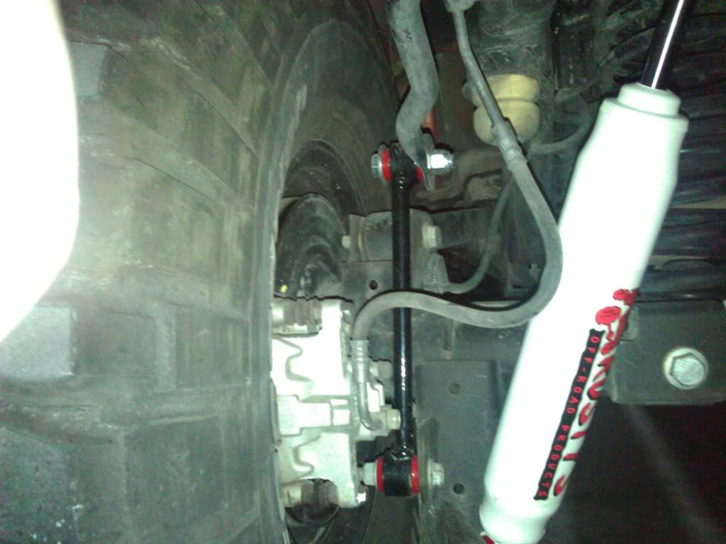

Pics of rear sway bar link. I needed to trim the bolts so nothing would rub during flex. I also made a bracket for my rear brake line drop. (nothing special) This was long overdue.
