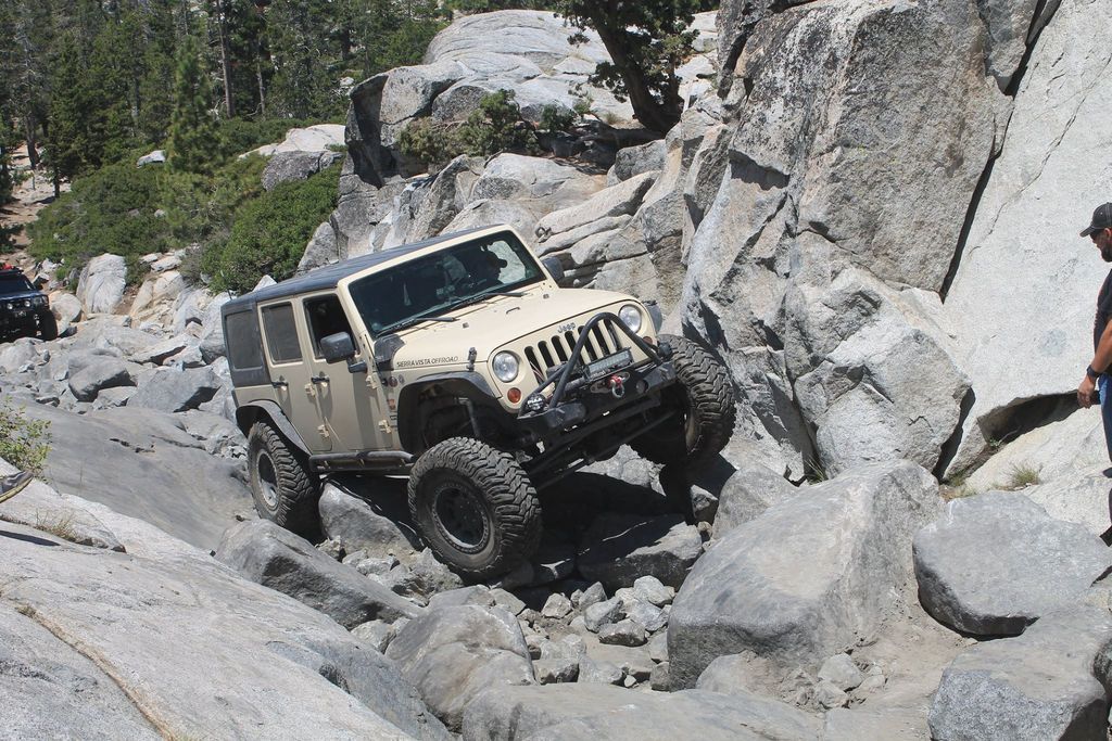

Here is mine, the JK is not the problem, its my lack of driving skill that makes my JK an anchor. I just got the RK lowers because I bent the stockers at the mall. Dont worry though, I have a winch and my wife has a strong back, so she can help with pushing the JK. I run MC front lowers, thats okay right?
No ... Its going to explode LOL
