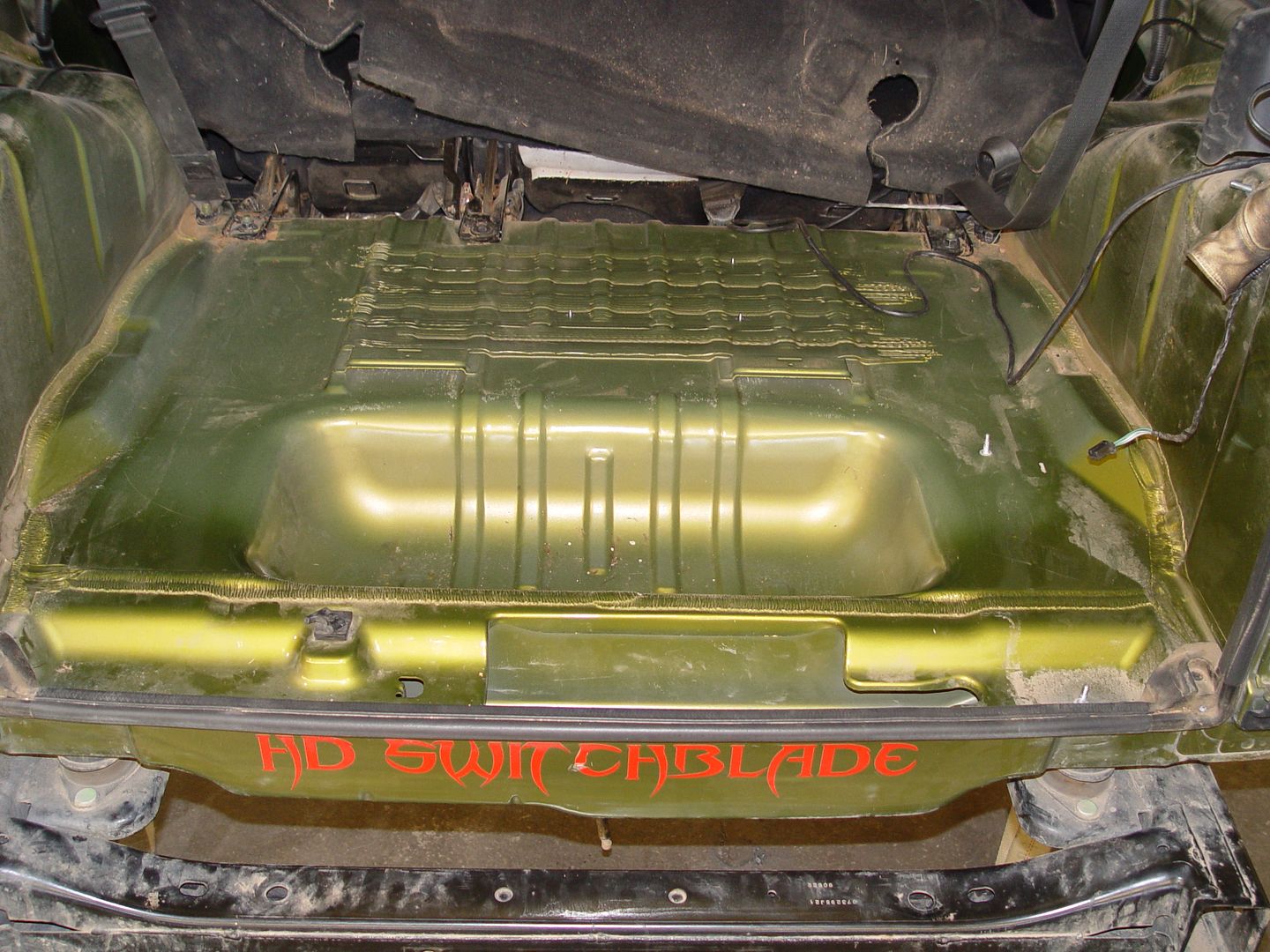

That worthless bump goes the wrong way. Out it goes.
Then make some mounts and put the winch in:
Then a little cover and bedliner
You can see the "scaffold" for the lever system in this pic
With TnT magic, they got it done. Actually they pretty much changed all the EVO mounts, relocated them, adjusted the length of the arms. The EVO Lever is set up for 6" lift. I wanted to keep the COG down, so it took a lot of work.

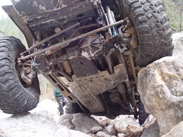

I really like the TnT y links up front i have seen pictures of them before but they are not on their web site. Could you snap a few pics of the y links for me? I'm interested in how they mount up on the crossmember. Is it a replacement crossmemeber or do you use the factory one? Thanks for any pics you can send and your Jeep is just SICK!!!!!:beer:
2
Here you go. The first picture is REX. The second pic is the TnT Rig. Mine has the same set-up
These Y-links mount to a TnT replacement crossmember, the mounts come set up on it.
Rex is has been the final testing stage of the Y-Link system. I tried to beat the snot out of it and it held up (for example I slammed straight up Rocker Knocker in Pritchett once I worked my nerve up). They have done a couple other rigs, and are now offering it commercially. Having had and broken previous suspensions, I like this TnT stuff. They got it "pat proof" which means it ought to be tough for just about any rig. Bob (the TnT owner/Guru/Boss) says the website upgrades are coming soon. Call Rod at TnT to learn more.
