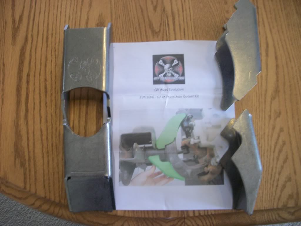

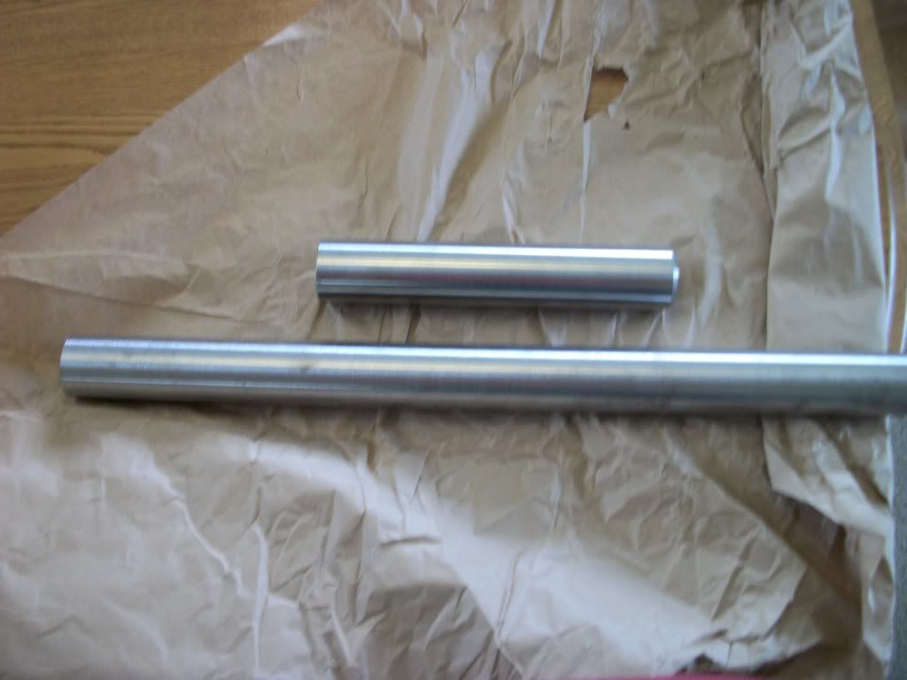

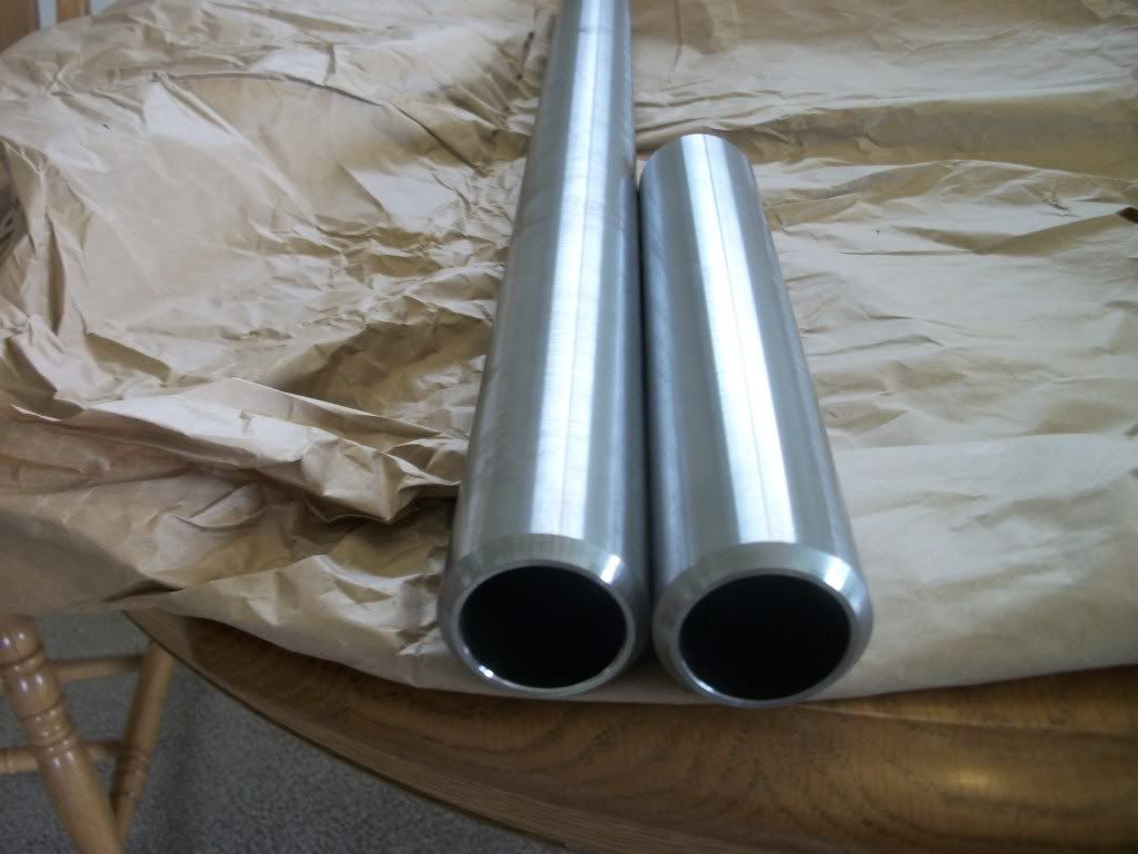

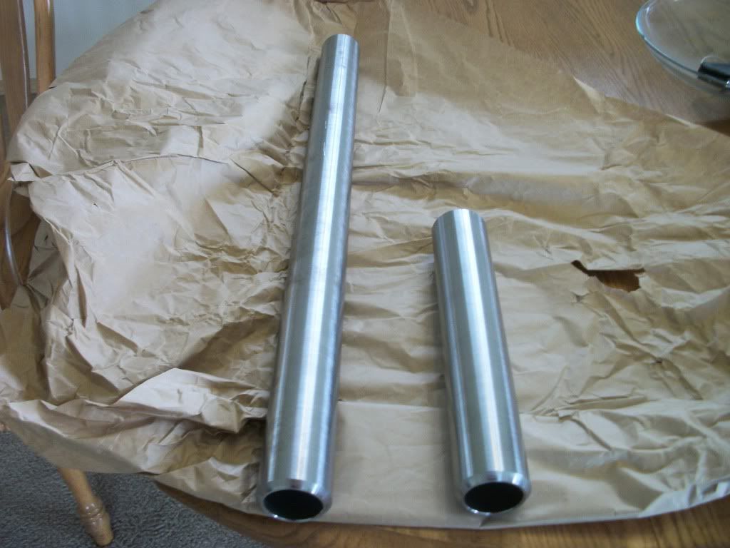

WELL i bent my axle tubs and gussets so now i am going to add some things to the front axle and see if that will help. the JK D30 and D44 both have thin tubes and can be bent if you play to hard. so here is my fix. weld in 3/8 a steel tube in side the axle and weld on a gusset kit and see how that works. the tube kit is from teraflex.
pics.
gusset kit
