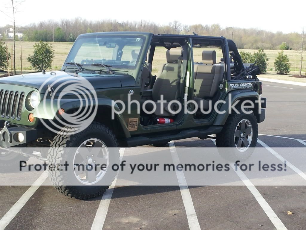

Started the Jeep tear down few days ago, so I thought I would post up my experience. Heres how she sat before the body tear off
