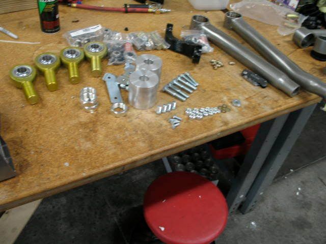

UPS showed up and I of course like a kid on Christmas was ready to put the Uniball bushings on the jeep. However, I have seen Johnny joints before and these were no Johnny joints. They were definitely a cheap copy of a johnny joint. So much so that before installation I found they would have to be modified to make them stay lubed.
Here is the bushing that I got and was told a Johnny joint was on its way.
Here is the problem I found before installation
Once installed both halves would be squished so tight that no lube from the zerk fitting would ever make it to the uniball. It would never get lubed. These had to be made by the same cheap company who had made those high quality first rubber type bushings. And they are! A company called Summit Machine makes Full tractions bushings. Or from what I can tell. If you are ordering a lift kit make sue you stay away from ANY kit running ANY of their bushings.
It was evident I would at the very least have to drill some holes into the new bushing halves to allow grease to make it to the center of the uniball.
I installed the new uniballs and knew that I would still have problems. With the two halves bottoming out before the proper preload was set on the spanner nut you would have a uniball to loose in the outer halves and a sloppy ride with premature wear.
Well this is EXACTLY what I had. A crappy ride that felt as though the jeep was all over the place. Not to mention I still had the problems with the track bar, end links, and a new problem that arises.
When I reinstalled the control arms I had installed the quick disconnects that came with the kit for non rubicon models without the electronic sway bar.
These were a tad bit longer then the factory rears that were to be moved to the front but no where near as long as other companies disconnects or replacement end links included in the JK kits.

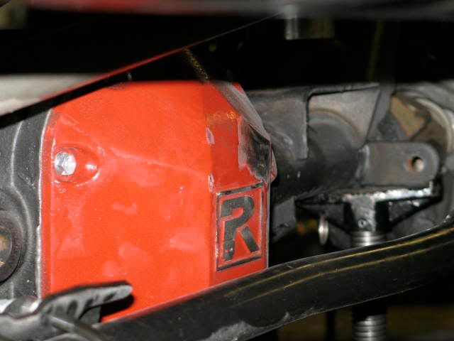

I had another trail I was going to do and once again I could not make it through the trail. The swaybar end link folded over the Tierod again and I had to drive home disconnected.
· Registered
556 Posts
Discussion Starter · #4 ·

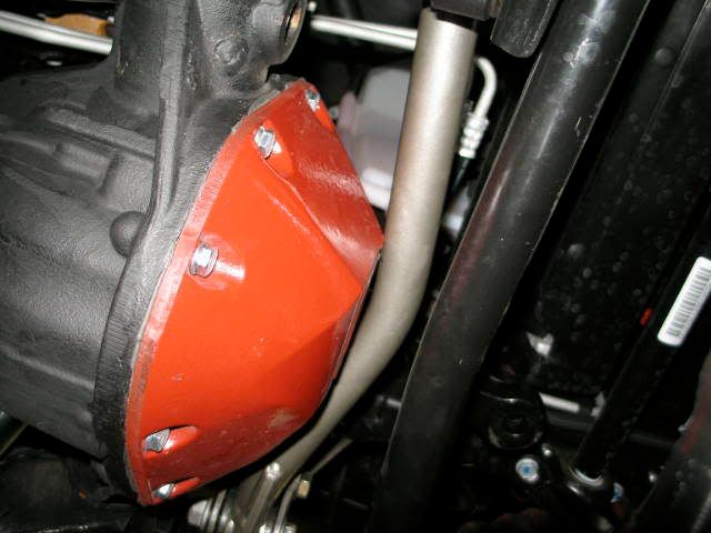

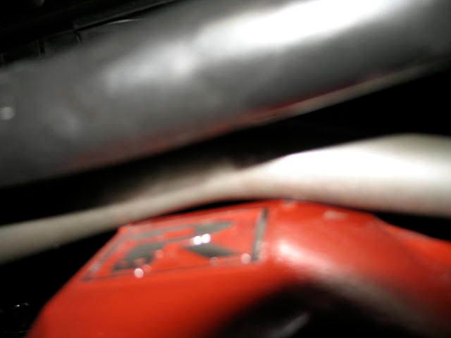

I got it home and parked it in the garage. The following morning I woke up to what I feel was the worse thing to have happened yet. I know hard to believe with all the troubles but it got worse. I had fluid behind my tire on the front on the ground. I did the dip test and it was oily. It was break fluid. While most manufactures on their 4" kits use replacement stainless brake lines the Full Traction kit uses a relocation bracket. This bracket does not properly relocate the brakeline causing the factory brake line to rip apart where the rubber meets the metal formed piece causing a leak.
This is when I decided enough was enough. I still had 3 more factory brake lines on the jeep that were mounted with the same bracket. My jeep had around 1100 miles on it.

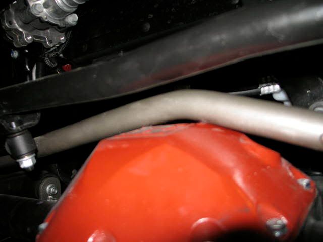

After getting everything back assembled I now have another problem that needs fixing. A ripped front Rubber Brake Line. I now have to replace the front and probably rear brake lines as retaining the factory brake lines like Full Traction does with this kit is not a viable option as they extend to long and break.

The diff cover was not stock...so I'm sure if you had a stock cover the issue would be fine. As for the longer bolt and rear bump stops..the stops are slotted to allow about 1/8" of movement...I had the same problem. I adjusted the extensions and lengthened the lower arms about 3 threads and the problem solved. The bushings splitting...looks to me you put too much pressure on them when you buttoned up the bolts. Did you put them hand tight...then put weight on it and then torque them? Not saying your not having any issues but being in the industry for a number of years most of your issues look to be fixable or install error. I have the exact same kit with no issues other than I stated.
