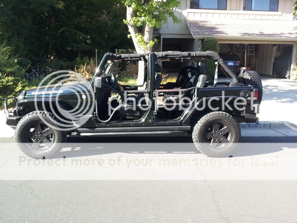

I started out with a black forest green 2012 JK Unlimited Rubicon, 6 speed.
On the maiden voyage home from the dealer in Canoga Park.
Where I'm at now:
Armor:
PSC Brawler Lite with Skid
PSC Front and Rear Steel Crusher Flares
PSC Body Armor
GenRight Rear Aluminum bumper with LEDs
ACE Rock Rails, installed over stock Rubicon rails
Electrical
Dual Aeroforce Gauges (green) in Auto Meter A-Pillar mount
Warn 9500 cti with synthetic line
Dually D2's (driving beam) in fog light mount
sPod
Cobra 75 WX ST
TruckLites LED Headlamps
Ghetto Green LEDs behind front bumper
PSC side LED lamps mounted in front fenders
Engine
Airaid air intake (oil-free filter)
Wheels/Tires
Stock 32" BFG MT
Plasti-dipped stock Rubicon 17" wheels
Miscellaneous
MetalCloak support for middle of rear seat
VersaMount2 with RAM phone mount
OR-FAB rock doors, front/rear
OR-FAB mirror retrofit bracket with side mirrors
SpiderWeb Trailmesh
Tuffy rear security deck
Tuffy glove box
Tuffy center console insert
Custom aluminum shelf mounted under driver's seat
Drake aluminum fuel fill door
Recaro ProRide
Here's how the JK sits today:
Where I'm Going
Stuff on the way or already here:
4.5" front / 3" rear Synergy springs
MetalCloak front/rear control arms
Fox steering stabilizer
Fox front/rear shocks
EVO weld-on sliders
EVO Rock Star skids
EVO Protek full skid system
Teraflex HD Hinged spare carrier w/ hi lift mount/rotopax
Synergy Sleeve/Gusset for front D44
Synergy front/rear track bar
Synergy chromoly tie rod
PSC D44 diff covers, front/rear
External CB speaker
50" Paramount LED light bar
PSC aluminum windshield light bar mount
Evap Skid
Ten Factory front/rear chromoly axles
Reid knuckles
PSC Extreme Duty Crossmember
37x12.50x17 Nitto Trail Grapplers
Method NV Black wheels
