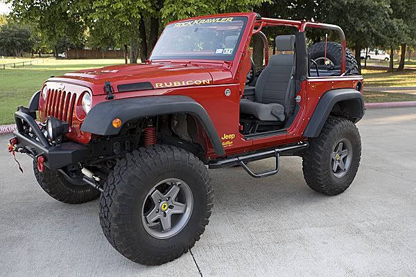

The guys at Atomic 4x4 in Austin Texas installed this RK long arm suspension on my JK. As with everything else that I've had done at this shop the quality of work was outstanding. Atomic is not just a service shop, they are master fabricators & welders and can handle any job. Here are a handfull of pics. I'll post wheeling pics soon!
One note about Rock Krawler: This is my first product that I've bought from them. The kit is huge and shipped in 16 boxes. But every little nut and bolt was there, very complete. Quality is off the scale good. And instructions are also top notch. Great outfit - thanks RK!! / and no, I don't work there :)

2 years later and LOTS of wheeling, I can say that I love this suspension:beer:

Long term review can be summed up in a couple of sentences.
After 3 years and 50K + miles I still totally love this suspension. I didn't get out on the trail hardly at all in 2012 :( but prior to that the thing has been wheeled a lot with no issues and outstanding flex. On the road it rides great. For as tall as it is, very little body roll.
Over the winter sometime I'm going to replace the frame side rubber bushings but that's more of a preventive measure. I may also change my coilovers and lower the rig about an inch. I have the Polly weld in rear coilover brackets so I'll be going coil on the rear as well.
So, if I was going to start a new build this is the exact suspension that I'd go with again (budget permitting). Its pretty expensive but its not a lift. Its a replacement suspension.
