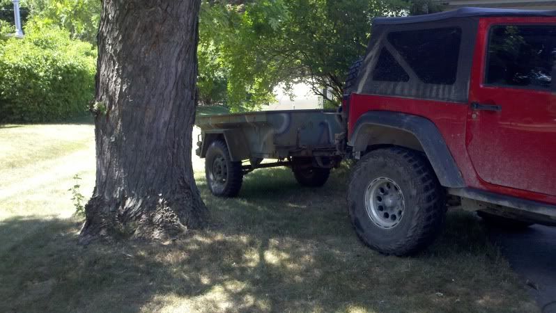

Just picked it yesterday on my way to work. It's in very good condition. Surface rust here and there, but not holes anywhere. It pulls really nice, but those NDT tires scream going down the road. I have some stock JK wheels with some ATs just like the ones on my teardrop that I can bolt on. I just need to swap hubs (if that's possible with the stock axle). I don't even know what bolt patter the stock hubs are. Anyone know?

You will need to have spacers special made (that's how I did it) or replace the compleat axle. There are no replacement hubs with different lug patterns available for the stock M-416 trailers.

Hell that is what I just sold my 416 axle for. I believe that the bolt pattern on that is 4.5 x 5 so you would have to run an adapter to run JK wheels. Take some pics of your rebuild.
Close....
M416 is 5 on 5.5, this was due to it's service time in relation to the Jeep still being used as a service vehicle in the military (60's & 70's) and the two having interchangeable tires. Think of it as the CJ5 & 7's and their hub pattern...:D
Adapters are a viable solution, just make sure they are not the beveled hub type like Spidertrax.

Lug-centric adapters can be picked up cheap enough. Then again, JK wheels wouldn't look as good. Some flat OD would help, but the stockers look cool.
Realistically, I won't likely do much of anything for a little while besides fix the hitch coupler. In the closer photo, you can see a previous owner welded a section of square tube and a ball couple onto the lunnette. I want to cut it off and grind the lunette back to a usable state. Then unbolt it and fab up some sort of bolt on reciever so I can use either my 3 axis coupler or a ball coupler like I have set up on my teardrop.
I know a lot of people like the classic look, but I both like the look of JK wheels and the interchangeability of running the same wheels on both. Even now, my current trailer has JK wheels on it...saves on carrying two spares.
That's ultimately what I did for WranglerV8 right before I sold him my M416 as he didn't have a MaxCoupler.

I've never pulled a 416 with the pintle hitch, but I've pulled large dump trailers with them and they were loud. I've heard the 416 was just as bad or worse. Seeing as it will be pulled offroad quite a bit, and seeing as I already own a Max-Coupler, I don't see a reason not fab up a reciever. I also already have a 2 inch ball coupler made for a reciever. I use them both with my teardrop camper so this would just make for interchangeability. I do want to make the receiver a bolt on deal though so I can go back to the lunette. I'll have to see if it's possible.
Here is a few photos of the ghetto hitch setup...
