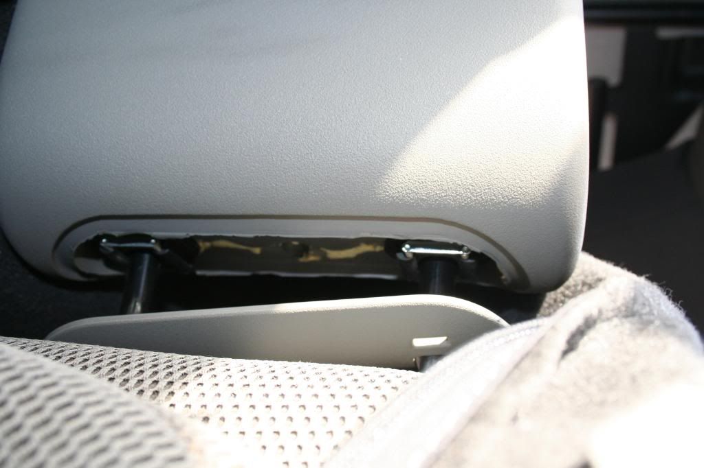

I did this write up on the other forum so if anyone is interested here ya go
fold the seat down and locate the zipper on the outer lower corner of the seat, you will have to gently pry it out. unzip the zipper and unsnap the lower part of the seat cover pull the seat cover up. before you raise the seat to finish pulling the seat cover up remove the cable that is located in the same area as the zipper just twist and pull in one motion. fold the seat up and pull up on the cover it is Velcro to the seat cushion so you will have to tug a little. now pull out on the seat cushion you don't have to remove it. you will now see the bracket for the headrest remove the two 8 mm bolts and pull that friggin bracket out. If you haven't done so already make sure you have pulled the head rest cushion off by removing the lower cover and pushing in on the retainer (spring loaded silver bar). now remove the clip that is holding the cable to the seat frame by twisting while pulling with a pair of pliers. now put the cover back on and repeat on the other side, I removed the other side blind by just sticking my hand up the front of the cover without pulling the cover off completely.
Enjoy
