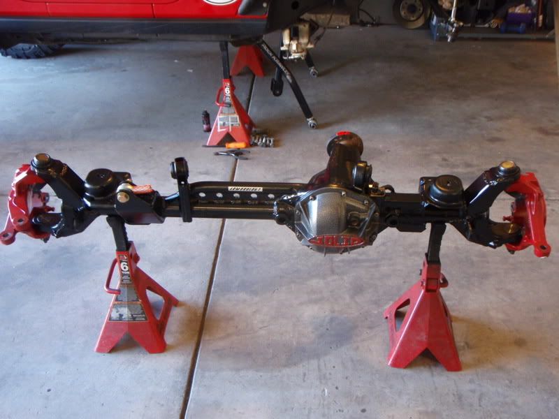

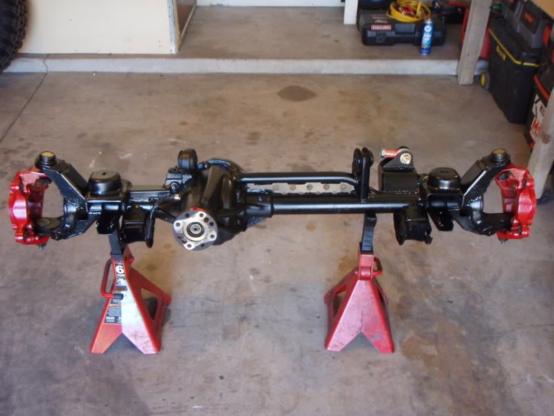

Can't decide between trusses, sleeves, gussets, chromo shafts...? Why not do it all? This one should last a while!!

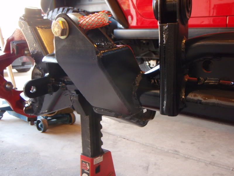

*RockKrawler Truss

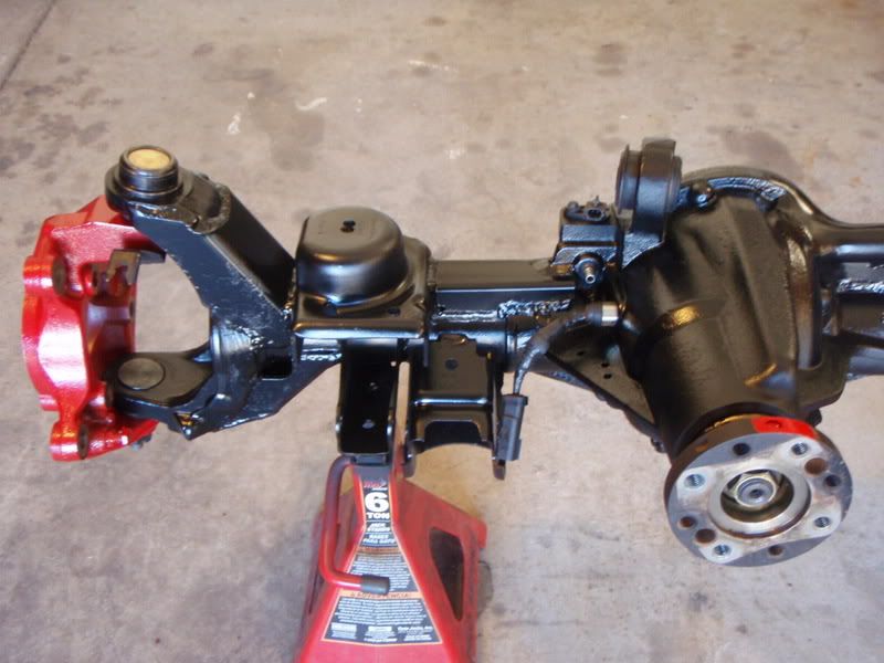

*Mt. Logan Tube Sleeves
*Evolution C-Gussets
*Evolution LCA Skids

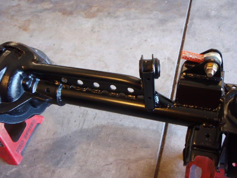

*Home Made Track Bar Bracket, Cut and Bent by ARMOROLOGY.
*Home Made Short Tube Gusset
*Welded tubes to Diff Housing
*Crown HD Upper and Lower Ball Joints
*FK 45,000lb Track Bar Joint

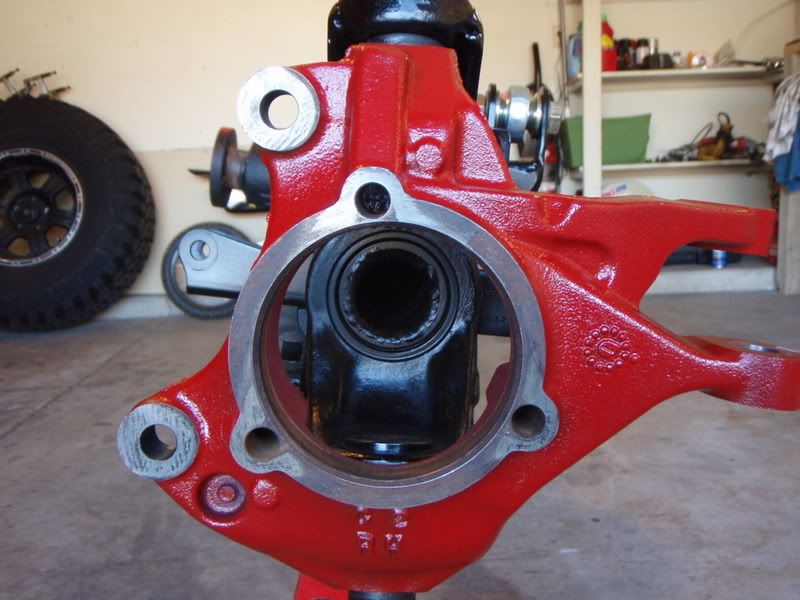

*Super Man Red Knuckles

um...can I hate you? :thefinger:
Best reinforcing JK axle modifications to date imo.
:beer::beer::beer:

If you don't mind what is the total cost? I'm curious as to how it would compair to a junkyard D60 with new innards.
Nice I wish I had trused mine when I did the gussets and tube sleeves. Oh well guess I'll do it one day
About $450 for parts. (Not including shafts or gears). Did the work myself, so that was free.
any info on the type/ size/ diameter steel used for the short tube gusset?
Wonder if I could pick up a piece like that at Tractor Supply or Home Depot?
