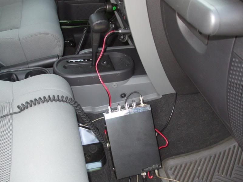

I have a Cobra 25 mounted on the passenger side of the shifter with a Ram Mount, And it works good! The only issue is that i can't slide the seat forward anymore.
Here is the pic before the install, And as soon as i get another digital camera, I will take more pics.

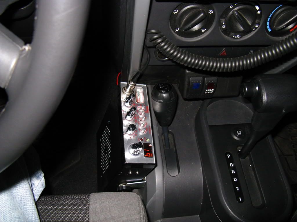

BTW, mine's mounted like Big A's, only on the driver side of the tunnel.

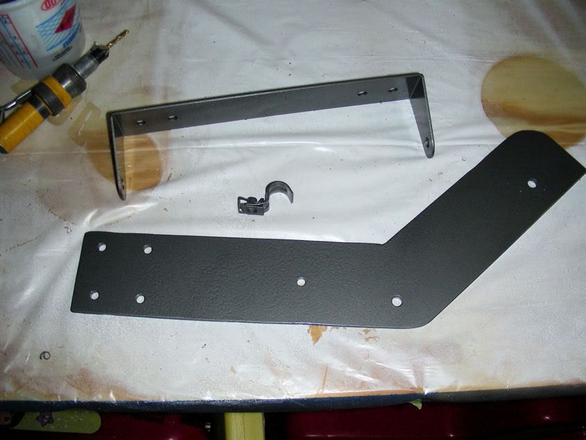

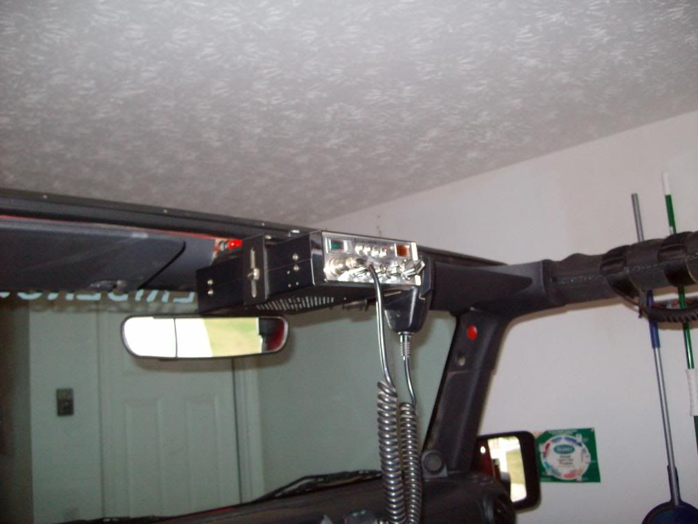

Hope Bodyguy doesn't mind me stealing pics from his photobucket account (guess he hasn't seen this post), but here is how he did his and how I plan on doing mine. It seems to work real well....he made the brackets and has made me one whenever I get a chance to get it and install it...

Very similar to how I did mine, but I mounted mine straight.
OK, not really. I made a bracket with aluminum flat bar and attached to the upper windshield frame and used hose clamps to attach it to the footman's loop. Works great.
