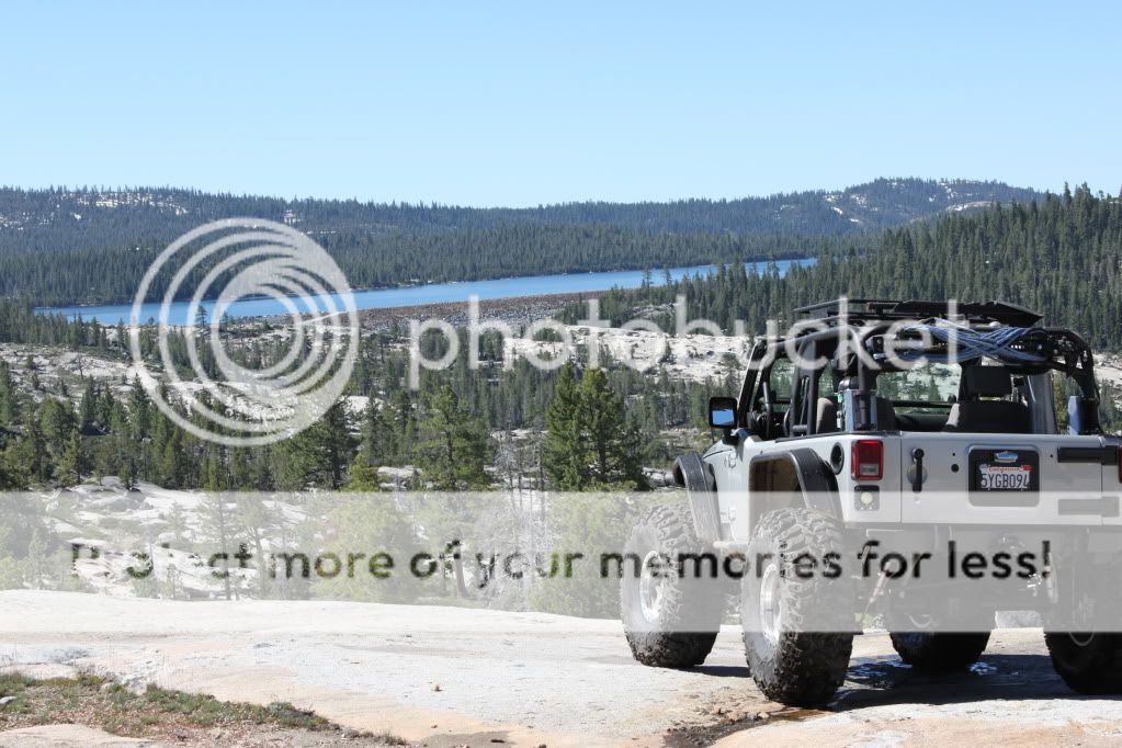

I finally got going on this stretch. I took alot of ass-end damage this year on the trail, so I am going to do a little thinning of this gals hips.
I purchased a Synergy Stretch this past summer but because of the change in plans to go with a buggy backhalf, I chopped it up and I am going with a one off 3-link instead.
This is what it looked like before I took my 5" cut-off wheels to it:
