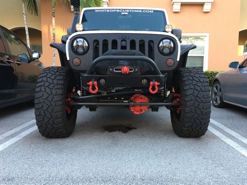

Install is done. Thankfully wasn't hard at all just time consuming. Took about 3 hours to do the first and then 2 hours to do the second once I knew what I was doing.
One thing interesting was the synergy joints I took out were fine even after 50k miles on 37x13.5" tires. I was always anal about greasing them with synergy grease every 5k miles they had no play and were still serviceable. I was installing my new rancho high steer knuckles so just figured I would put in some new ball joints while I was in there anyway. Have to say the rare parts are a good looking ball joint, if there is such a thing. Time will tell how they hold up!

everything looks really well put together , thought out and good, @Biginboca. Yeah, the perpetual " we shall never know why some have sh*t luck with Synergy Mfg BJs and some of us they just last and last and last" differing experiences, it would seem . I am in latter boat, also. I now grease them by 6th sense I have done it so much, heh.
I just wanted to say that and that I like your Rancho knuckles. :jeep2:

Can't quite say anything special about the ride is due to the rare parts yet I guess having any new ball joints is definitely going to give you some nice feel to the steering, right? I am digging the fancy look though, lol. One last pic of my new axle bling...
