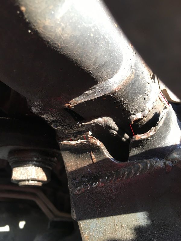

So this past friday i had an interesting day. i was on an of ramp when i hear a very loud bang and the jeep stopped turning and started going straight! when i was able to stop the jeep i had ended up half on a curb blocking the rest of the off ramp. once i pulled the seat out of my ass i got out to see WTF had happened. at first i didn't see anything, so i hop back in to get out of the way. i get going and the jeep is super loose i start to slow down and hit the brakes and death wobble , so i pull off and give the jeep a better look now that i'm safely out of the way. i look at the front track bar mount and its cracked almost completely off .
I bought the jeep with 60K on it and it already had a procomp 4 inch lift with 35's on it. i had an issue with the track bar mount before (it cracked a bit lower on the mount and i added a plate and re welded it) so after another 60k of mostly highway driving and some weekend warrior wheeling if broke at the frame( as you can see in the above picture. i was lucky enough to get it towed to a local off road accessory shop and they got me back on the road by the next day. the shop cleaned up the re welded it back on , but suggested a more permanent fix. they suggested replacing the old garbage with just a new stock mount (they said a drop bracket was not needed for a 4 inch lift) . this is the route i will most likely take but i think an adjustable track bar . does anybody make an after market front track bar mount? and what have you guys done to beef up your track bar mounts

Artec trac bar mount. It should be used with their truss for more strength.

FINALY FIXED for real this time
So my track bar mount cracked again, I'm not surprised just look at that shit show above. so a friend of mine hooked me up big time. i already had a synergy mfg 3217 track bar frame bracket. He was able to get it welded up and it solid.
