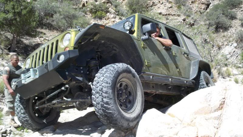

Absolutely hammered the tierod last time out on the Rubicon. Bent the tierod which in turn caused the steering stabilizer bracket to puncture the stabilizer also causing the shaft end of the stabilizer to rub on the track bar as the tierod rotated backward. Also the pin that held the swaybar link to the axle bracket drivers side is gone. Second time this has happened. The thing is that it tracks straight down the road. I drove almost 200 miles from the trail to home. Let go of the steering wheel and it tracks right down the middle. I did a simple measurement between the front and back of the front tires and it shows 1/4" toe in. I don't drive it enough to notice any unusal tire wear.Should I leave it as is until the tierod bends some more? I don't want to replace it right away if I can get away with this for a little while. I'm going to lose the stabilizer though. The RE relocate bracket doesn't work for me. I have so much flex in front it just gets in the way.

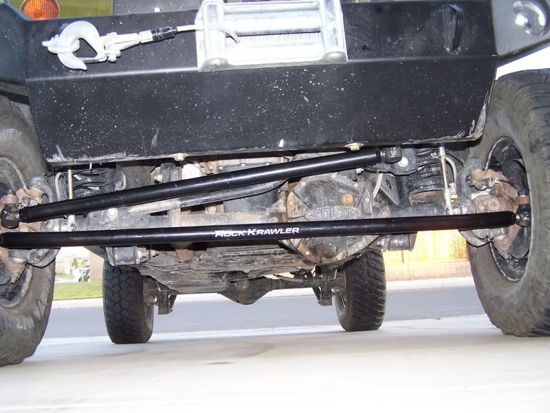

I saw your setup on a different thread. I tried looking up Rock Krawler and couldn't find anything related to a tierod. Can you provide a link?
its on there website under suspension build componets rigth by the drag link
http://www.rockkrawler.com/
Why are you happy? You haven't even scratched the powder coating how do know it won't bend like barbie when you take it offroad?

because thats a pic when it was installed months ago it has been VERY used scince i installed it

Is it just me or is that tie rod bent in this pic? It doesn't look anywhere near as straight as it does in your freshly installed pic above.
that was the 4th stock one they are all in the junk pile on the side of the shop now hahahah

here was my soulution and couldnt be happier

nope no reaming involved if you use the moog tie rod ends that they suggest wich were rather expensive like 60 bucks each then its a bolt in deal and they are supposed to be releasing the high steer kit wich reuses there tierod and drag link si the upgrade should be inexpensive
