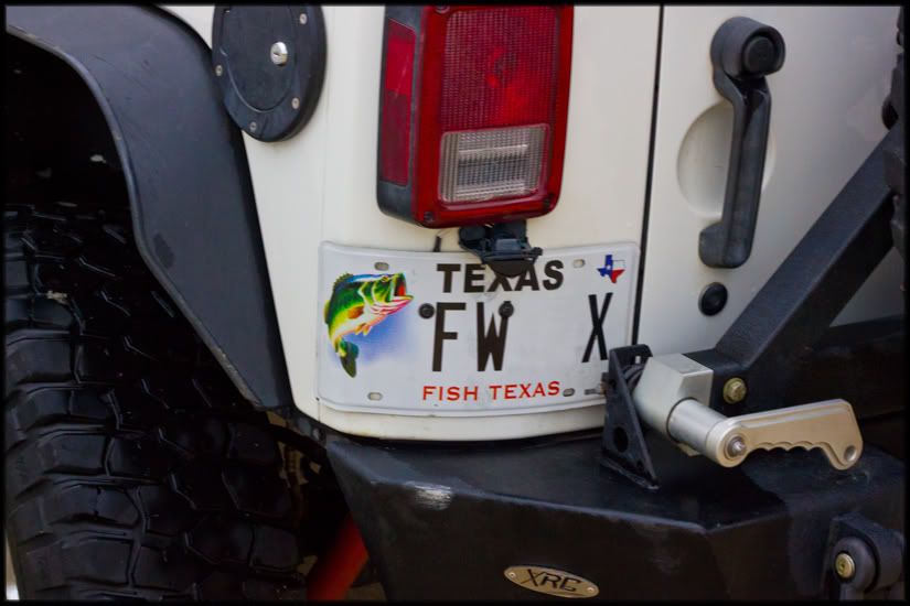

Forever ago, after my second broken license plate holder, I figured I'd just cut off the stock light and mount the plate to the tub using the stock bracket holes. I notched the tail light to hold the light, it was intended to be temporary..but has been fine for over two years.
Anyone else done this with theirs? Haven't seen it, just sharing the idea. :beer:

I like the look. Its the center of the spare tire mount that I hate. That's where Jed Clampit put his license plate before driving to Beverly Hills.

I wonder what that would do for photo radar cameras?

Probably nothing, there is hardly any curvature to it. But it is covered from a pretty decent angle from the spare tire, we don't have such devices out here.

Did you put anything on the back of your plate to keep it from vibrating and rubbing paint or did you just firm it and screw it on?

I have some very thin "foam tape" that you'll find at lowes/home depot near the garage/door weatherstripping..comes in a roll. I use that to keep the majority of it off the tub.
I pressed the plate against the tube to show where it needs to be bent, removed it and bent it more so it'd hold tighter.

I haven't had any issues. It's sucked up very tight to the tub. If I catch the plate, the tail light, gas fill cover, fender and lots of paint are going with it!

I did this when I had my TJ, hadn't considered it on the JK. Not sure how I feel about it with the angles, the TJ had that nicely bezier'd corner. Definitely solves the plastic plate holder issue without all the BS involved in moving it to the Jed Clampit location. :laughing:

I like this!!! What are you using for the plate light? Where did you get it?

That is the stock light actually, it met the dremel.;)
