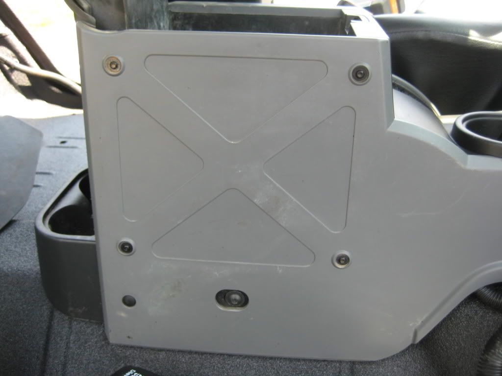

next take out the 4 torx screws, two on each side, see pics below
rear screw in the center on the pic
then the front screw
now you can lift the console off from the rear

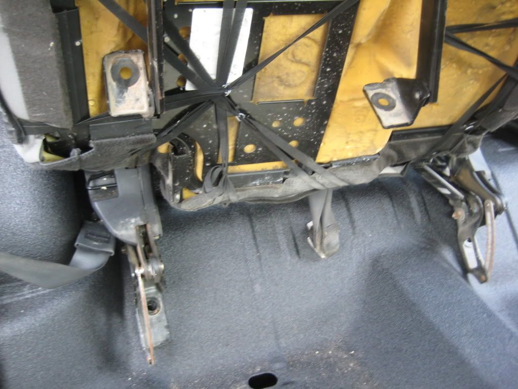

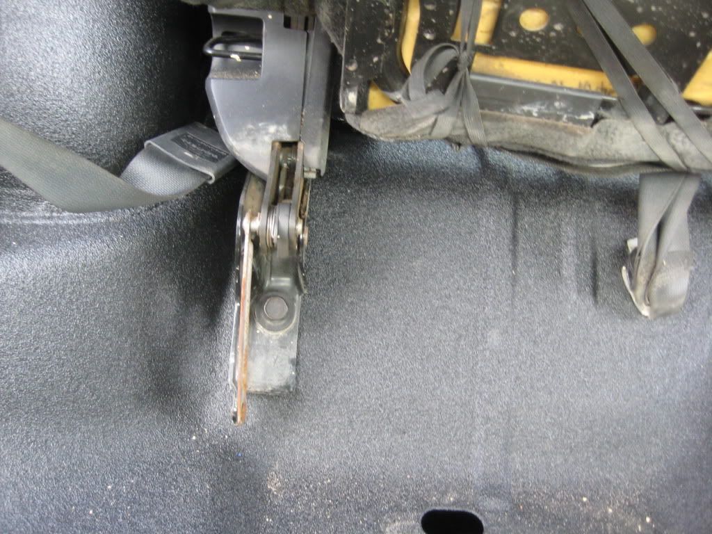

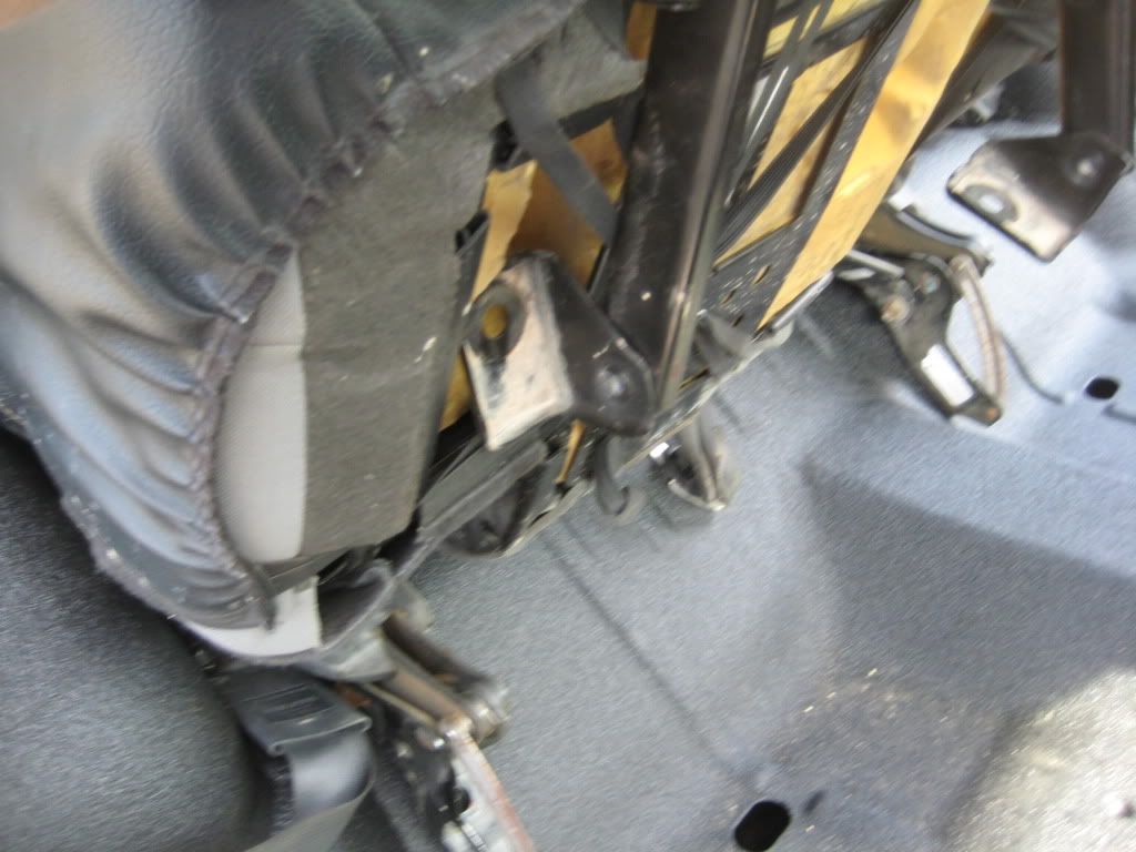

the rear seats on the 4dr have a ton of red locktite holding then on, they only get torqued to 55lbs, remove all the front leg screws completely then you can flip the legs up and the bottom of the seat back so you can get to the bolts on the angle :crazyeyes: you need at least a 6in extension, 10in worked better, there are also 2 nuts on the rear of the seats you can get after the angle ones by flipping seat forward, and one that holds the center seat belts. there are also two nuts you have to remove on the side of the drivers side rear that hold the two seats together.
rear seat legs
folded up
bolt hole

only way to get to that bolt is having the seat flipped up
