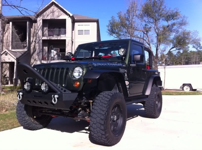

For a point of reference, here's a customer's rig on a Rock Krawler 2.5" Max Travel we installed. He has trimmed stock flares and 33s...

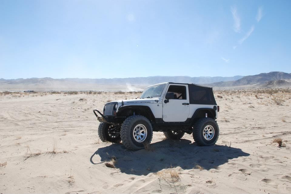

I've run the 2.5 X-Factor on three different JKs now, two of them being 2012s.
This is my 08 with 2.5 X-Factor, Poison Spyder armor & flares, and 37" Goodyear MTR/Ks.
This was my short lived 2012 on 37" MTRs in the first picture and 35" Toyos in the second:
