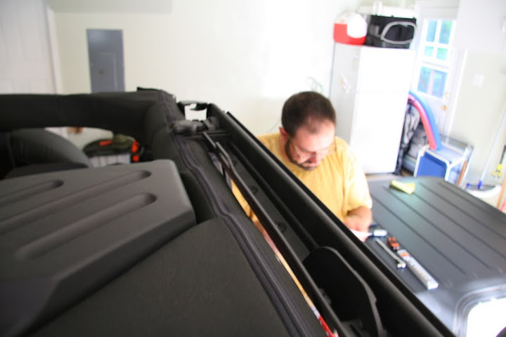

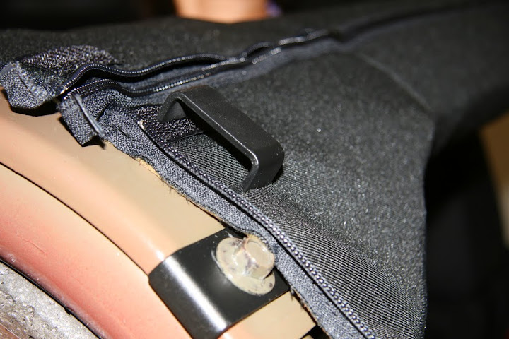

STEP 2: Install the rear support brackets for the rear retaining bar and side spring tension clips. There are 4 brackets (2 driver's side and 2 passenger's side). You'll have to cut a slit in the canvas roll bar covers. Just roll back the covers, position the bracket and cut the slit where the bracket will go through the cover. Very easy. All four brackets use existing bolts in the top of the roll bar.
My four-year-old daughter helped by unzipping the roll bar covers and handing me the ratchet.

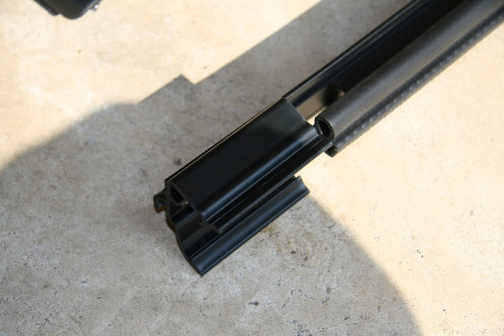

Step 2 continued...
Another picture of the finished brackets.
Step 3: Install the door surrounds. Rears first. They install just like the factory ones. In fact, they look VERY similar to the 2011 factory surrounds.

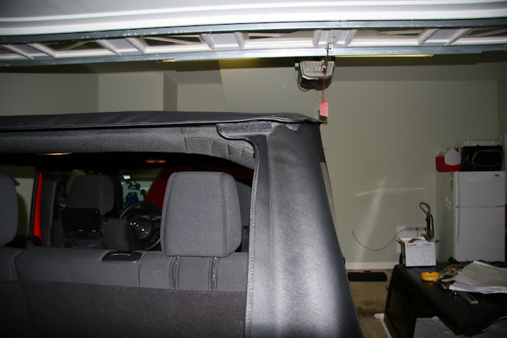

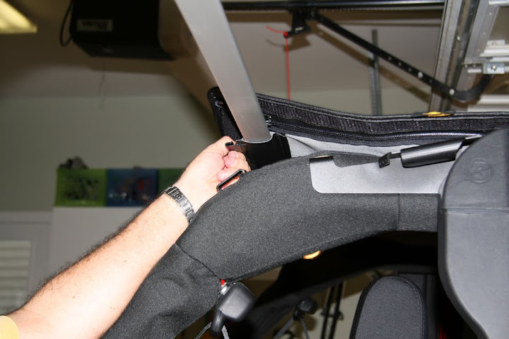

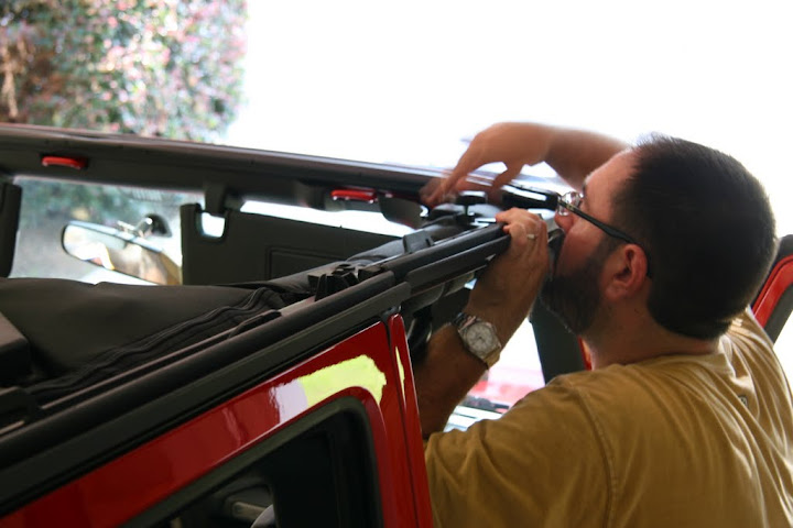

Step 4: Install the roof and front header bar. You'll need to attach the included foam insulation stickers on the corners first. The foam is intended for fabric and probably should go on the corner edge of the fabric. However, on my OEM top, this is where I kept having leaks, so I put it on the plastic header and haven't had any leaks. I think if you put it either on the fabric or the plastic, it makes contact with the windshield channel and won't let water in either way.
Also slide the center metal rod to support the center of the top. Once the roof is installed, the rod snaps into a slot on the door surrounds.
Step 5: Secure the roof to the Jeep. The instructions say to attach the header bar first. Pay no attention to the instructions. Just leave the header bar loose above the window frame, don't latch or lock the header in place just yet. You don't want to create any tension yet. Instead, just place the canvas top above the Jeep and drag the rear of the canvas top towards the rear of the Jeep. The instructions also say to snap the center rod into place before placing the rear retaining bar. Once again, pay no attention to the instructions. Simply lay the top and center rod on the door surrounds so that the center rod is just behind the center rod support brackets. The canvas top should just be laying on top of the Jeep unsecured to anything.
Now, slide the rear retaining bar through the two brackets we attached in step 1 and then through the slot in the softtop. It helps to have a very soft top (read: warm outside to make it soft) so that the top stretches enough.
This is what it should look like on both sides once finished.
Once the rear retaining bar is installed, you can stretch the canvas top forward and latch the center rod into place. This is what it looks like when you eventually snap it in place in the door surrounds. You can also see the main top rail attached to the bracket that is screwed down between the front and rear door surrounds. It's the pivot point for the sunrider top. The rail attaches to the bracket with a quick-release type hinge. Pull on the knob, slide into the hinge plate and release the knob. The pin latches into the hole on the hinge.
You can latch the front to see how it fits and make sure it aligns properly. Note: You will have to unlatch it in the next step to install the tension springs.
Continued...

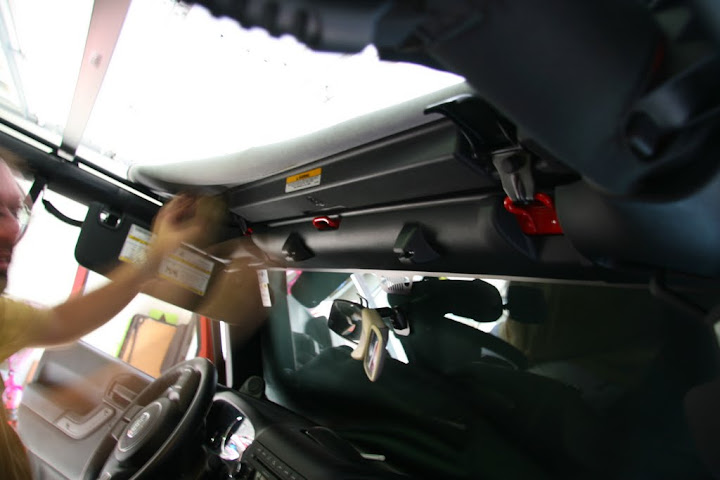

Step 6: Attach the spring tension clips. The instructions don't say this, but I found that if you unlatch the softtop and fold the sunrider portion back, the spring clips will fit right in. If it's still too tight, you can unlatch the center support rod and make it looser. Don't forget to re-attach the center rod afterwrads. Also, make sure you go under the screw that is built-in to the door surrounds.
Use the outer-most hole for now. As the top stretches, you can create more tension by moving it further in.
Here's what it looks like once it's finished and the top is locked and tight.

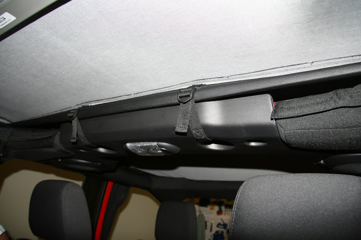

Step 7: Attach the inside straps to the sound bar. Self-explanatory and very easy. They attach to the existing hole where the hard top panel screws go.
Go ahead and latch and lock the header bar at the point. It's going to be a little tight, but again, if the Jeep is outside and it's warm, it's not too difficult.

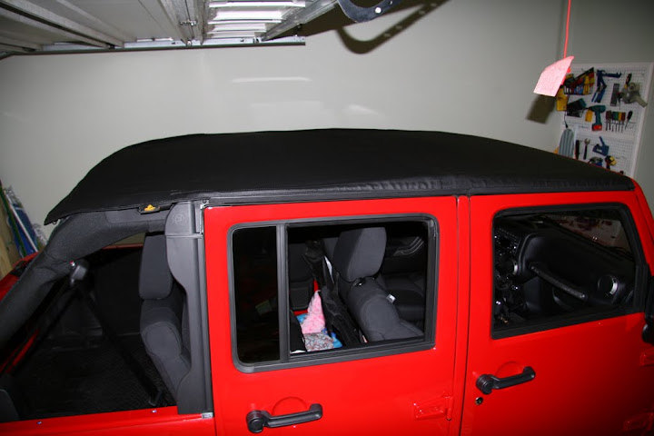

You're done with the top portion at this point. I left it like this for the rest of the day since it was nice out. I'll continue the thread when we install the sides and rear windows.

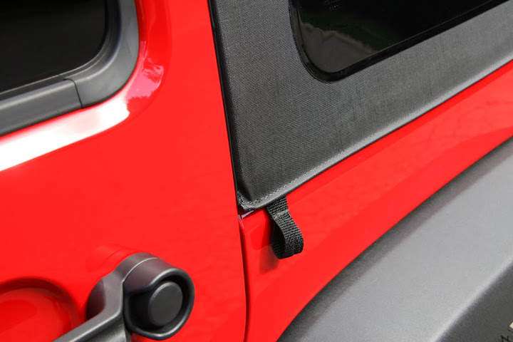

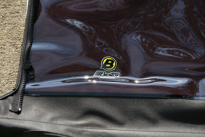

I went ahead and installed the sides tonight. A little tough since the zippers are really deep dehind the door surrounds. The side towards the door and bottom attach just like the factory tops. Slide the zipper just a few inches, then snap the door-side edge inside the groove, then finish zipping and pull the the window down and snap the bottom edge in.

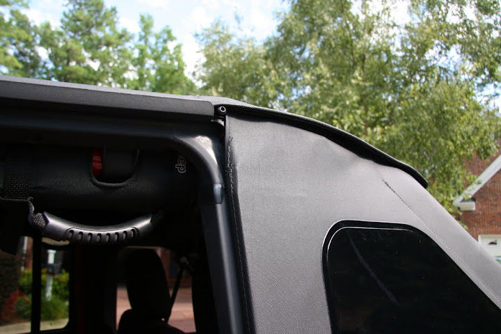

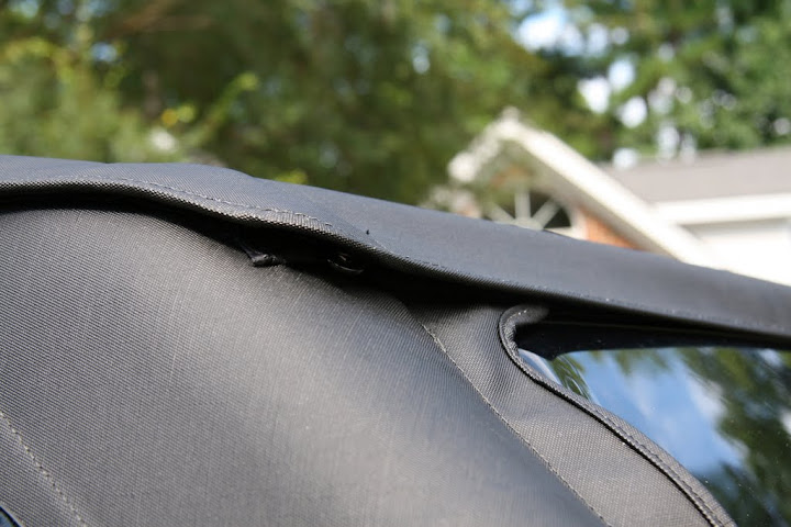

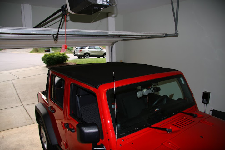

It stopped raining and I was finally able to take some pictures of the finished product in bright sunlight.
The top "rail" of the rear window tucks far up underneath the top, so there's no chance of rain getting in there. There are only two zippers on the rear window - left and right. The top uses a hard plastic snap it rail to attach to the roof portion. It's secure, but doesn't lend itself to rolling it up and letting it dangle there. Although I guess you might could do it.

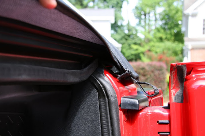

This is the only complaint I have with the design of the top. The rear retaining bar has the side clips built-in. Therefore, in order to secure it to the tub, instead of snapping it in place to the clips that are securely attached to the tub, you actually need to clip the retaining bar onto the tub each time. I find that a bit cumbersome, especially if you need to open and close it to grab stuff from the back.

The Trektop NX comes complete with everything you will need to install the complete top. The only thing it does not come with are storage pouches or window rolls to protect the rear windows when removed, rolled and stored away. The quality of the materials, fit and finish of the Trektop NX are excellent - same as or better than factory. The Trektop NX comes with everything you see here:
Starting at the top of the picture, the straight aluminum bar is the rear retaining bar, the round black pipe is the center retaining bar that slips through the sewn-in loops in the canvas top, the two aluminum arched support bars are the removable center supports for the canvas top (to prevent sagging from collected rain, snow, etc), then the rear door surrounds, the front door surrounds and the tailgate bar is at the bottom of the picture. In the center is all the hardware.
The header bar comes from factory attached to the canvas top shown here:
Hope this helps.

I agree that the tailgate bar is the last issue that still needs work. Like I said, I have the first gen...I recently started using the bestop tailgate bar after getting rid of my stock tailgate bar, and the design is horrible. This last trip out, I was trying to get the bestop bar off but because it was so cold, the plastic ended up being very unbendable and brittle. Well, wouldn't you know it, I go to snap it off and instead of coming off, the bar popped off and busted the rivets of the clips.
Now I have to either re-rivet the damn thing or figure out if I can fit small enough bolts in there. What a stupid design
I'm wondering the same thing. I think if the rivets popped off though, Bestop should be able to replace it under warranty. These tops have a lifetime warranty on materials. I think they would be accomodating if you ask politely.
I'd like to try to fit the stock tailgate bar on the Trektop. If I can somehow manage to get the Trektop rear window to fit in a stock rear bar, I'd be set.
