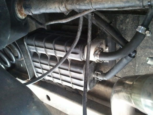

I want to update this with a few pictures. I have a 2" Rusty's lift and that gives me 6" between the diff and the canister, 5" between the axle and stock bumpstops. Assuming the foam doesn't compress more than an inch I should be good.
Also, the "required items" page of the installation instructions doesn't mention that you need hose clamps, but the instructions do call for them.

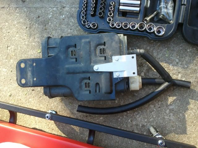

Here is the unit ready to be installed:
Here is the unit mounted:

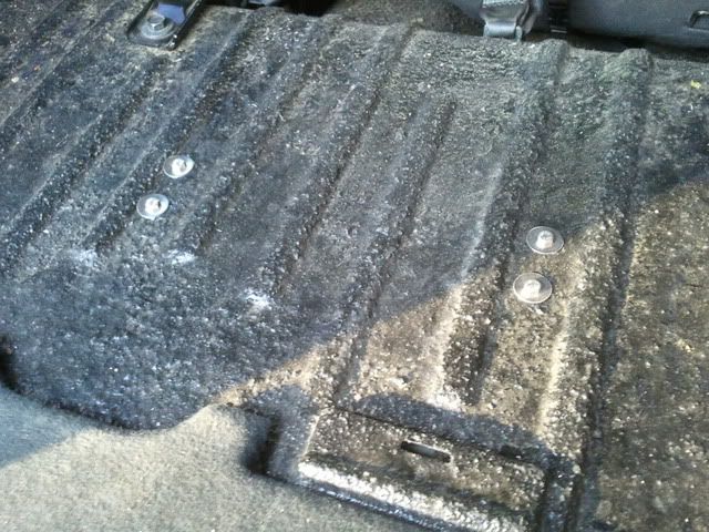

Reminder- you have to drill 4 holes in the tub:
