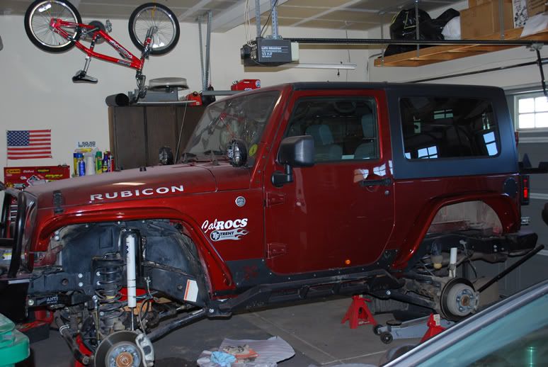

This covers the basics for installing the GenRight Aluminum front and rear fenders. There are several steps that are open to interpretation.
1. Remove your old fenders. I have seen writeups on this on the web already so I will not cover it again in depth. There are some bolts under the front fenders and some plastic body rivets that will need to be removed. Then pull up and back on the fenders. They will make a horrible breaking sound but they should be fine. the rear fenders are held on with plastic body rivets and will need to be cut or pried out. Then pull up and back like the front fenders. It will make the same noise as the front but should be OK.
Set the fenders aside. You will need to cut the liners out of the front later.
2. Remove all of the plastic clips from the mounting holes.
3. Test fit the fenders to make sure everything is straight and the holes appear to line up underneath. You will need to insert the nutserts into the body holes. On the first one I marked all of the holes with tape to make sure I did not put a nutsert into the wrong location. They provide a bolt with a nut and two spacers to help tighten the nutsert down.

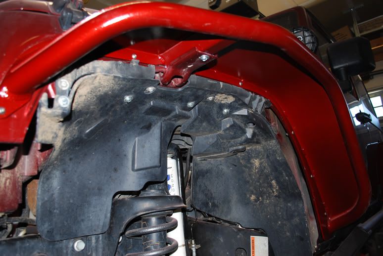

4. Install the nutserts into the body. They will take some pressure to force then in. There is one hole that will not be used in the front and two in the back. You can hold the back of the nutsert with a pair of pliers while you tighten down the nut using the supplied bolt.
The Top center nuts will require you to pull the body slightly away from the inner body structure in order get them to seat all the way in. If you try to tighten them down without pulling out the body the nutsert will just twist instead of expand. You will also need to add spacers to the bolt because it is longer than the space provided.

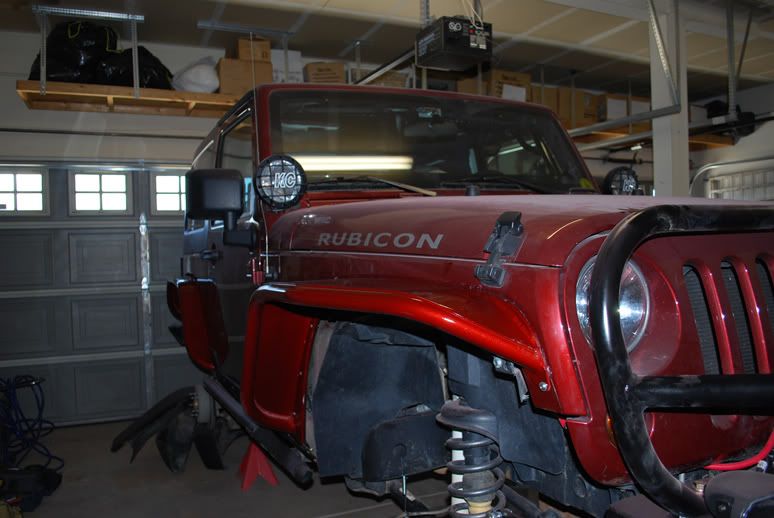

5. Once all of the nutserts are installed you can install the front fenders. Coat the mount between the body and the fender with clear silicone. (This is recommended but not required) Start with the two top center bolts then work around the fender using the Allen head screws to hold them down. A bolt was not provided for the fender brace.
Painted and installed with the fender liners.

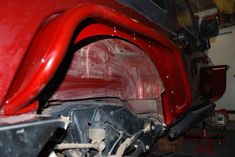

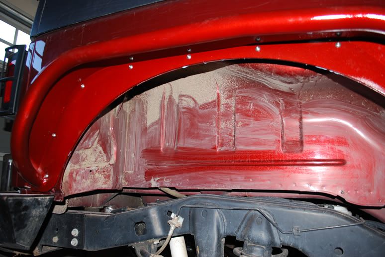

6. The rear fenders do not allow you to hold the nutserts from the back with pliers so you will need to hold them from the front. I used vice grips. Once the nutsert starts to compress it requires very little force to hold it. Edit a better suggestion to hold the bots was provided. This sounds easier to set the nutserts.
Originally Posted by OlMan View Post
Comment regarding the nutsert installation. You do not need the vise grips. The way I did mine was to put the two spacers between the oversize nut and the head of the bolt. This will allow you to use a 1/2 inch open end wrench to hold the nut and use your ratchet wrench to tighten the bolt. I also have a nutsert installation tool (HF), but it did not work as nicely as the supplied bolt worked.
7. You do not insert nutserts into the front top corner and into the bottom rear corner. You will need to drill a new hole in the body to install the bottom rear nutsert. Once you have all of them in you can test fit your fender and mark the final hole in the bottom rear corner show here with a black dot.
use an 11/32 bit to drill the final hole.

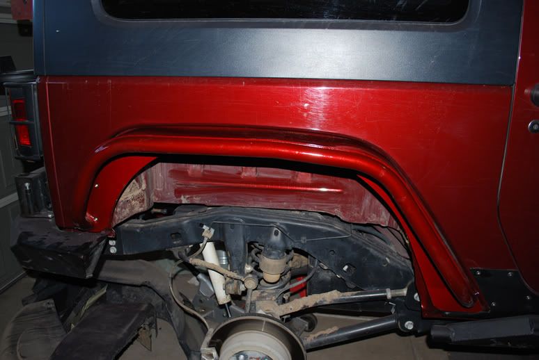

8. Install the final nutsert on each rear corner.
9. Install the rear fenders the same way as the front by coating the body mout surface with clear silicone and then inserting the top two Allen bolts first. you may need to push the fender out or in a little to get the holes lined up.
Painted and installed.
I was going to leave the rear liners out but I think I will put a portion of them back in to keep some of the mud out.
