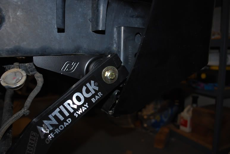

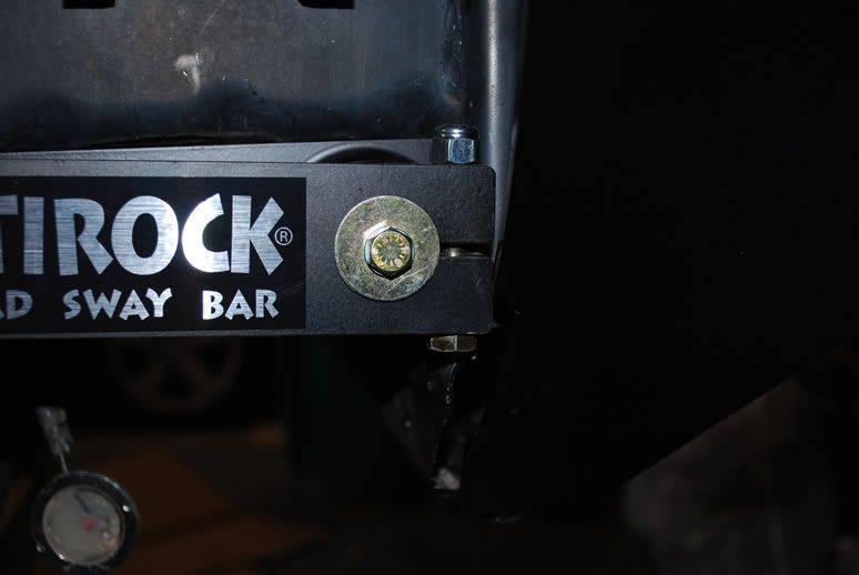

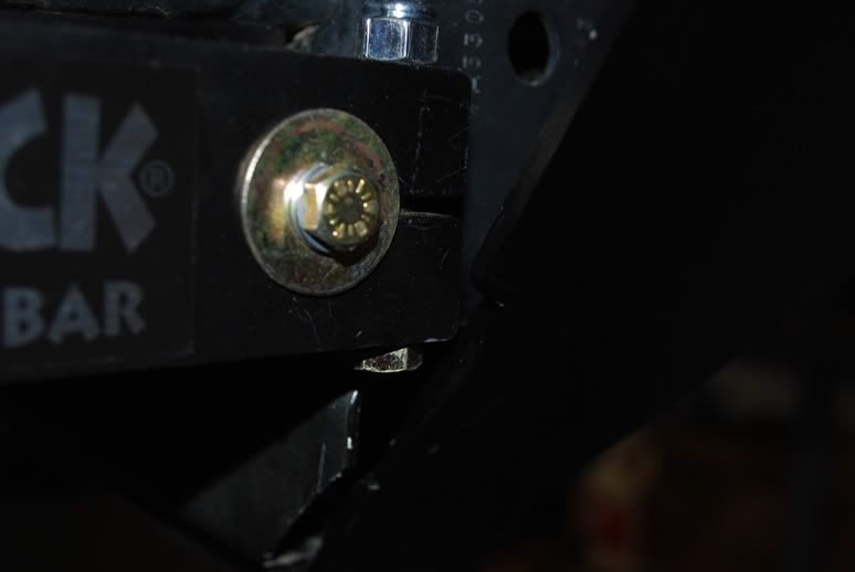

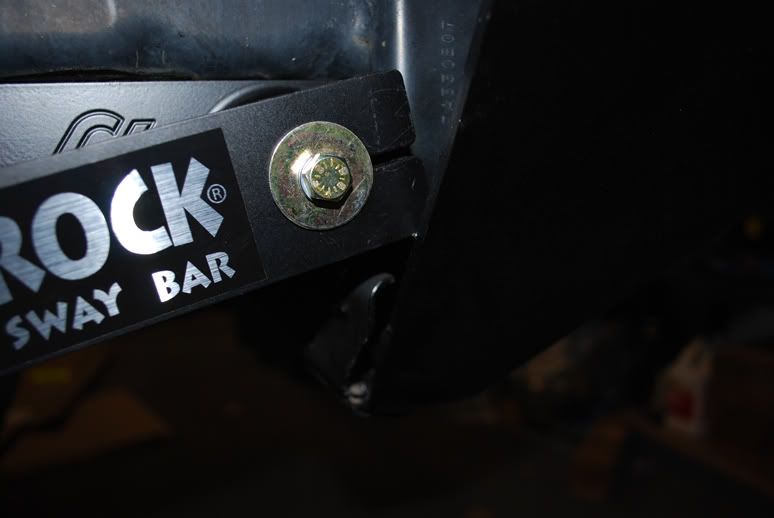

If you are installing or have a Currie AntiRock front sway bar you may need to trim part of the bumper. I was installing a new one and discovered the sway bar hit the bumper while rotating.
You will need to trim about 1/4" from the side of the bumper right at the top of the cross brace. I also had to install the bolts from the bottom as I did not trim enough to clear the nylock nuts.
