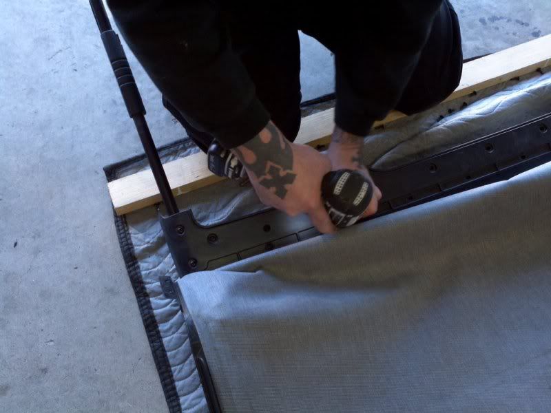

First remove the soft top, lay it upside down, we laid it on a couple blankets on the concrete.

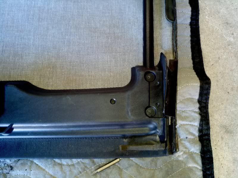

Next drill out the aluminum rivets on the small rods that connect to the sunrider brackets so you can disconnect them from the sunrider brackets.
Flip the header over to gain access to the screws.
There are 4 phillips head screws on each side of the header, remove them and fold the edge of the soft top away from the header.
There are a bunch of other screws across the header (didn't think to count them, probably around 16 - 20). Take them out and remove the plastic cover.

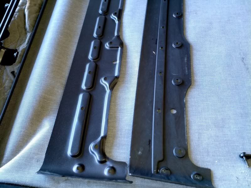

Here is the header separated from the fabric, the new metal support header, and the crappy plastic one that was on there.
Lay the fabric into the channel on the front of the new plastic header, throw some tape on it to hold it in place and insert the new sunrider rods into the header. Place the the metal brace over the fabric and replace the screws in the header careful not to over tighten. Place screws into the sunrider rods to secure it to the header ( the new rods appear to be slightly bent to provide more down pressure on the header to the windshield.
You are done. The difference is night and day. My soft top now inflates when the air is on like it should, there is enough pressure to cause resistance when closing the door, I can feel pressure in my ears when I roll up the windows, and best of all, i can hear the radio and conversations. The top is much tighter. There is a slight whistle, but I think I can fix that by replacing some foam tape that was on the corners. Oh, and here is one of the links that held the small rod bracket to the sunrider, don't know why it was bent, but that probably also caused some slack in the old top. The bolt they send with the new rods should hold up better.
