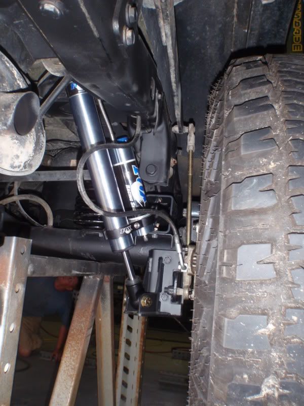

here is the finished product........
We used some 1.5 conduit clamps and some heat shrink tubing for the mounts.
Here is a shot form the side of the jeep, makes adjusting them super easy
Some finished install pics...
Dr.Dirty is offline

It took longer to mount the reserviors than it did to rebuild the shocks!
If there was ever any doubt on why Fox shocks are expensive today showed me why. They are easy to rebuild and in the long run you save money!
I could never get a clear answer on what the numbers meant on the adjustable shocks but Dirty figured it out.
1 - soft rebound (rock crawling)
8- hard rebound (heavy load)
I am running 4 on the road and the ride is smooth. Now that I can actually get to the adjuster I will get my money out of these shocks.
