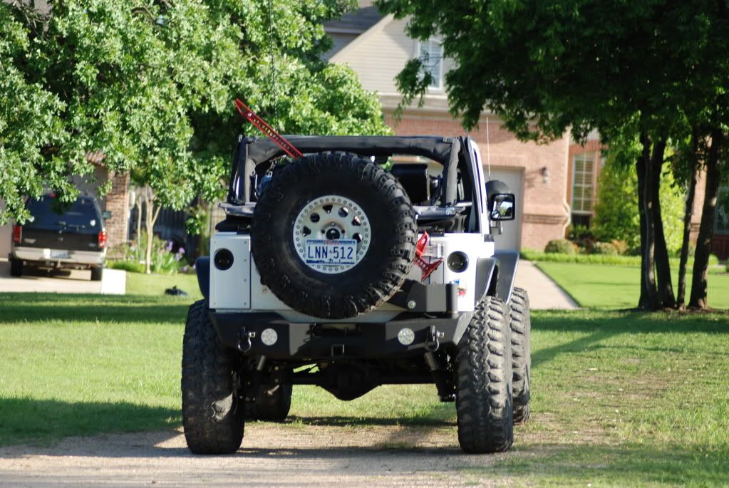

here are the final shots. I got lucky and still get to use my zoom zoom car race tip on the exhaust.
Over all the install was super easy and Ill get some action shots posted in the next week or so.

Some more day light pics
